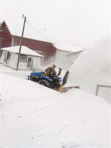

I have read multiple treads on them and am still stuck specifically at the same point. It almost seems that the answer is very dependent on how much time one wants to spend doing one thing verses the other as well the balance point between how big the tractor is compared to the snow or drift your confronted with. With the hills and not wanting to install chains I cant comprehend how an inverted blower could possibly work as well as a standard. I haven't seen any picks from anyone who has to go up hill first (at least nothing like what I have to do) without chains using an inverted one yet.
Maybe if I stumble on a real good deal for an inverted one I can give it a try but at this point I think I would only be happy with it doing the lower more level areas and end up having to switch the chains on and off for any of the uphill drives I do. That to me is the deal breaker as I really don't want to be wasting time fighting with the drifts and switching chains on and off. The main reason I have the blower is to minimize the work I do and speed my time frame up and unless everything is picture perfect I just don't see it happening with an inverted blower.

A large part of it has to do with the tractor pulling or pushing the blower. I got my rear facing blower because I couldn't drive much less plow my tractor through some snow (1.5' with 3-4' drifts), but I've only got a 32hp 3,500lbs machine. My neighbor with a 12k lbs machine has a very different outlook than I do. An inverted blower would do me very little good. I can plow faster than I can blow, so I always plow, but flip a 180 & blow if I stall out plowing or need to dispose of a windrow. I need the rear facing 3pt blower to push & chew through stuff I can't drive through.
Those inverted blowers seem to mostly be behind some pretty big machines. They are a lot more common in the commercial world where speed matters a lot & they are operating in denser areas.
