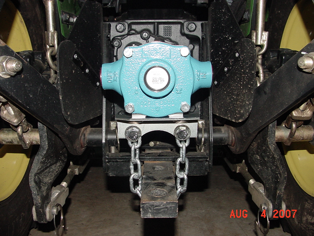

I would go with the 40 gallon unit and a PTO roller pump. The pump will set you back another 150$ or so, so for 600$ or less you would have a working setup.
The PTO pump just hangs on the PTO shaft with a chain to keep it from rotating.
