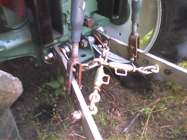

Here's how I did mine on my Yanmar. There was no provision out by the wheels to hook the chains to, so I made some links that fit over the 3ph pins and cross the chains. That way they're in the same plane...........

That looks like a good solution for long chains. Problem is I cannot do what you did. My chains attach to the outside of the lift arms not the inside.
