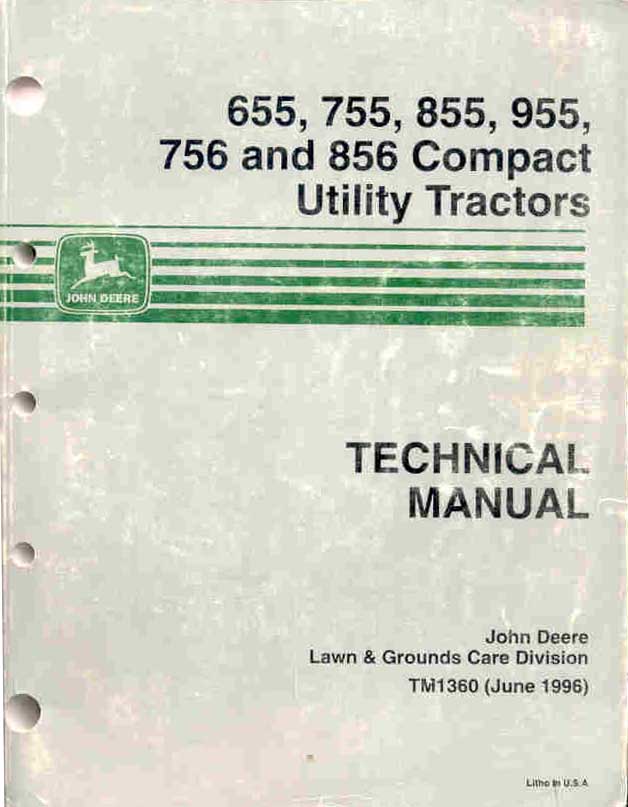

I suspect JD stopped printing X55 manuals when those model tractors went out of production in '97 or '98. I've posted a pic of the cover of mine if you are curious. The good news is that there are printing companies that make a living out of publishing out of print manuals. The JD dealer is the place to start. They will have a publishers name and number for you to call. I'm almost certain somebody still prints manuals for our "old" tractors. You should have no trouble getting one. Maybe even someone on this forum could provide the information for you?

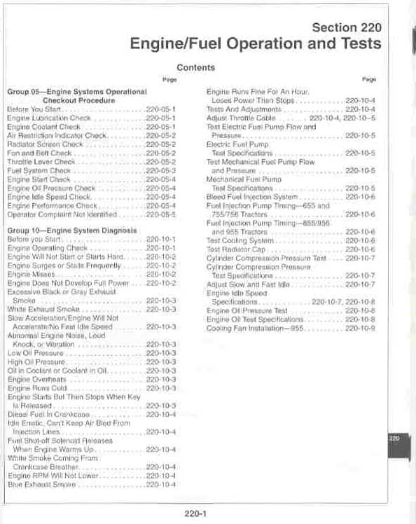

I am not a widely experienced Tech Manual person, but I believe this manual will walk you through about any project. I think it's the same manual the service guys use. I used my manual to help me rebuild a broken front axle spindle mechanism. There are many, many pictures illustrating every step. The sample I posted for your 3ph adjustment is a good example of how the book is put together. In my opinion, the manual is very comprehensive and written and illustrated so a somewhat mechanically inclined non-mechanic like me can work his way through. If you plan on keeping your tractor for a while you will probably get the chance to use it a few times.
<font color="blue"> the service manual for the Yanmar engine is a different publication. </font>
Yup.
<font color="blue"> How much of the engine is covered in the tech manual? </font>
The Contents page of the Engine/Fuel chapter is attached. The engine manual is detailed enough for overhaul/rebuild. The engine section of the Tractor Tech Manual covers more testing and adjustments rather than massive dismantling and rebuilding.
