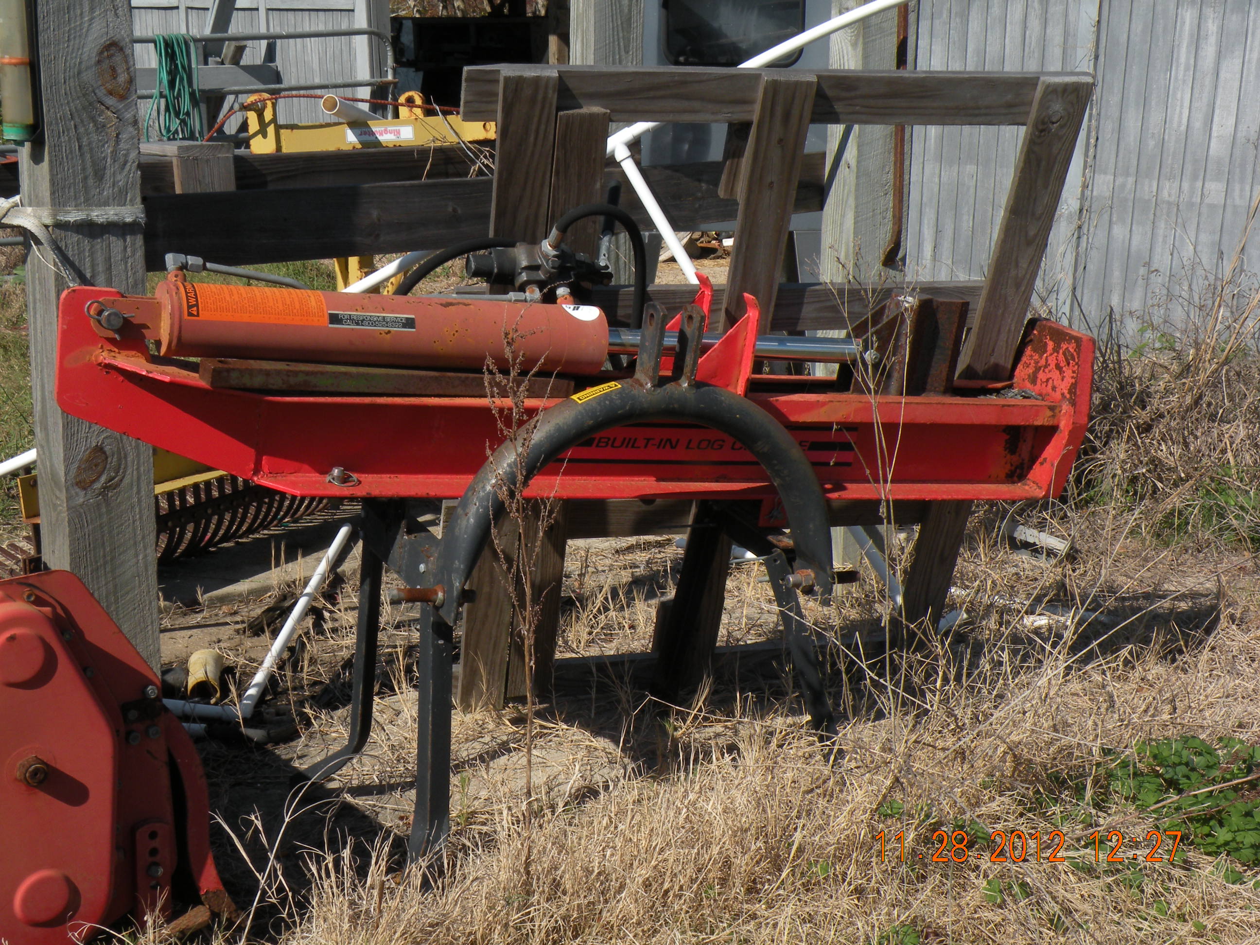

I have this one,, I got at TSC about five years ago.. been a good one.. it's 35 ton.. Never had a problem with it.. Lou
/ 3point log splitter #9
I have the same model that Lou66 has. I've had no problems. Fuel consumption might be a problem if you will be using it all day long but you don't need a big tractor for one of these.
