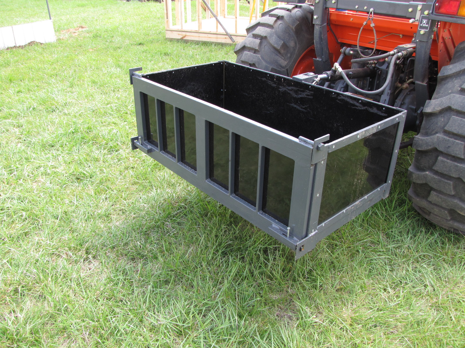

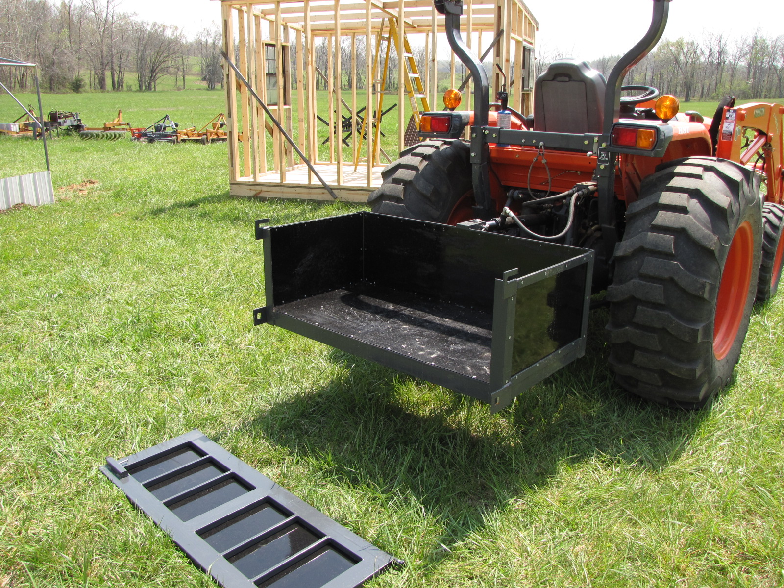

This is what I use. I fill it with sand and gravel when doing a lot of loader work, when done I just dump it out. Then have a nice big box or take the gate off and put cut off logs in it or ect.
