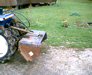

here's a bucket i made for my 3pt hitch,
made it out of an old diesel storage tank i was given and had the other bits lying around waiting to be used.
the hydralic ram i found in a skip with 3 others and the hoses as well. so all it has cost me is a bit of time and consumables.

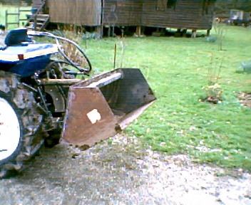

can't get picture to post. will try again.
the first picture works now so will try another one. picture quality is not very good as my camera was only 10 euros

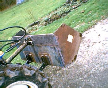

   / 3pt bucket
this time it's tipped

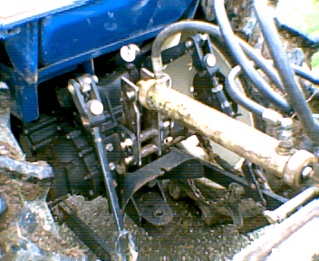

   / 3pt bucket
view of the hydralic ram and of the piece i had to make to raise the height of the top link fixing. with the ram in the standard position when tipped it ended up in line with the lower link arms and not at an angle to enable it to tip back up.
with the extension piece it works ok now.

Looks like a very handy bucket, and clever design and clean fabrication.
Thanks for posting.
By the way, what is a 'skip' where you found the rams?
   / 3pt bucket #7
I do believe on our side of the pond, we call them dumpsters.
Nice looking attachment, especially for the price /forums/images/graemlins/grin.gif
   / 3pt bucket #8
Good adaptation. Looks like it would take some serious abuse and not complain.
Cliff
   / 3pt bucket #9
Very ingenious indeed – this makes me wonder how many tractor and implement companies are going to copy your work.
   / 3pt bucket #10
<font color="blue"> "......my camera was only 10 euros" </font>
10 Euro's eh? Thats about 40 bucks here /forums/images/graemlins/shocked.gif Naw, not really, but with the sagging dollar it may seem that way /forums/images/graemlins/grin.gif
Great job, and nice pics too. It looks like a practical addition and some very creative design work. Just curious, what seems to be the most popular tractor brands in France?
