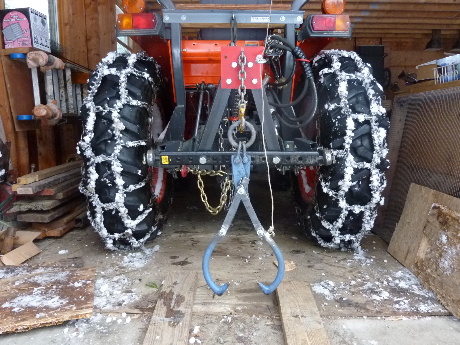

I guess I don't know why you haven't seen any responses yet. I know there are lots of people on here moving logs with that type of set up. There has been lots of discussion of the pros and cons of various equipment too. I have a winch but before that I used a cross draw bar with a tractor hook and chokers. I would think that what you are looking at would be as good or better than that. I also have this thing that I made.

I'm surprised by the lack of responses as well. I use a logging winch myself, and now that I've used it, I would never be without it. However, it is a lot of money to spend if you are not doing a lot of this sort of thing.
If you Google "Tractor Skidding Plate" you'll find a few other options:
Wallenstein FXP Skipping Plate
Norwood Log Hog
I've never tried these, but know there are folks on here who have used something similar. Before I got the winch, I would chain the logs to my box blade, or use a three point hitch draw bar (about $50) with a grab hook and some chain log chokers to skid logs.
