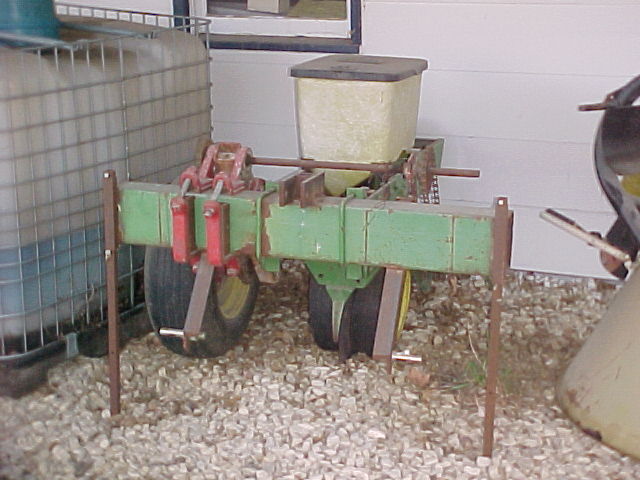

I have a 1 row JD 7000 planter I built. It is 3 point and has the JD transmision and is ground driven. It is in very good shape. I need to sell it. What is it worth??
I bought a 4 row air planter so I have no need for it any more.

DDT, I am in Oklahoma and might be interested in your planter.

I took some pic's to give a idea what it is.

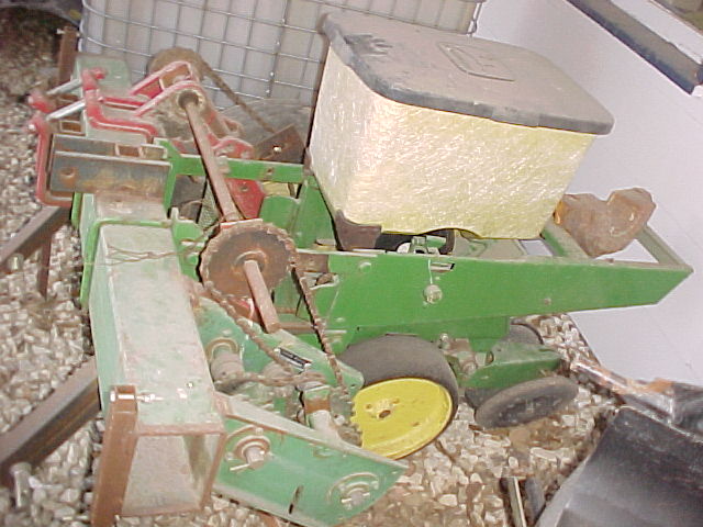

I have planted several different types of seed, does make a good stand. Pic's may be alittle dark, it is under a roof no sun gets to it.
