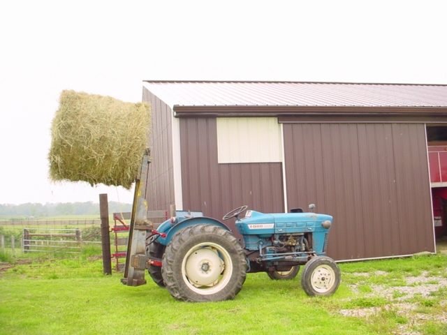

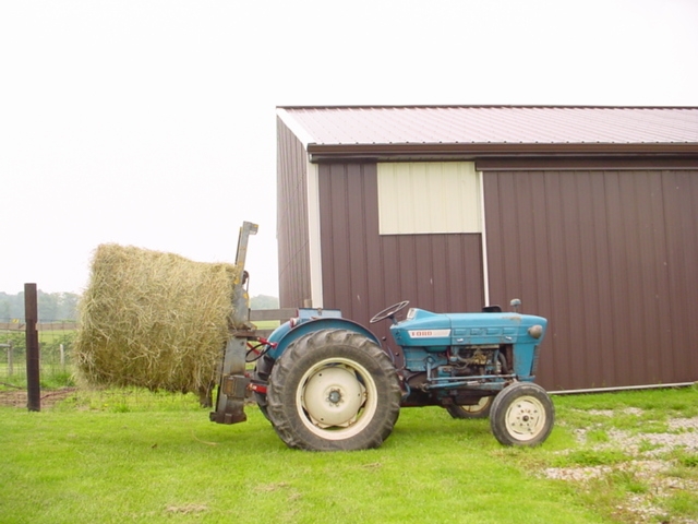

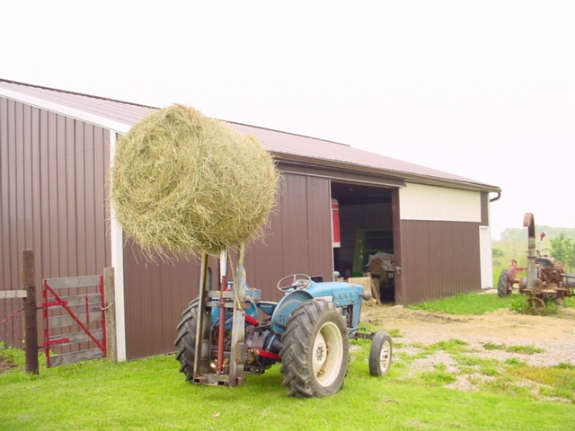

I built one about 15 years ago, mainly to double stack my round bales. The fork lift unit is that of a hand type fork lift. It is relatively light, and has the capacity of 1,000 lbs. perfect for the 500-600 lb bales. I removed the forks, and made a bracket for the bale spear, yet still use the forks. I did have to get a larger bore cylinder from Surplus Center, I'm thinking it's a 2" bore. Thank goodness it is one of those odd ball sizes, that wasn't all that expensive.
I've now graduated to a Bobcat to do the bale stacking, so put the forks back on it, and still use it occasionally. Last time I used it, was to set my waste oil furnace back up it's stand, approx. 7' high in the new shop after moving. Worth its weight in gold, when you need it.
