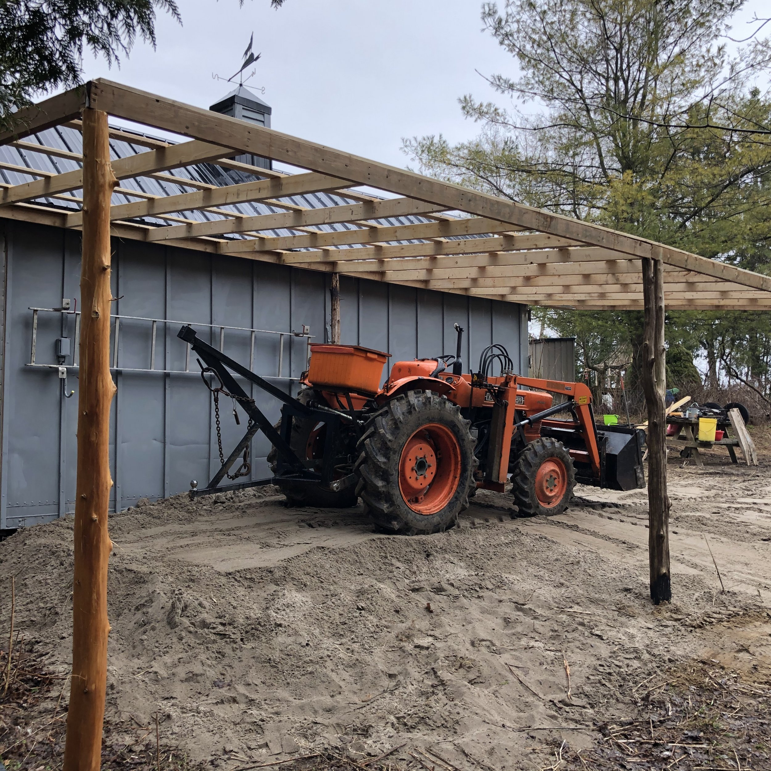

This is what I made to pull logs out of bush. I also use it to move trailers around. its simple easy and works well. I back up to log with it in down position , once it touches log I use my log tongs and hook to chain from top, lift until front of log is up and then drag. No problems and have taken out lots of big logs out of bush.
   / 3pt hitch and log mover #25
Good setup for stuff you can drive close to.
