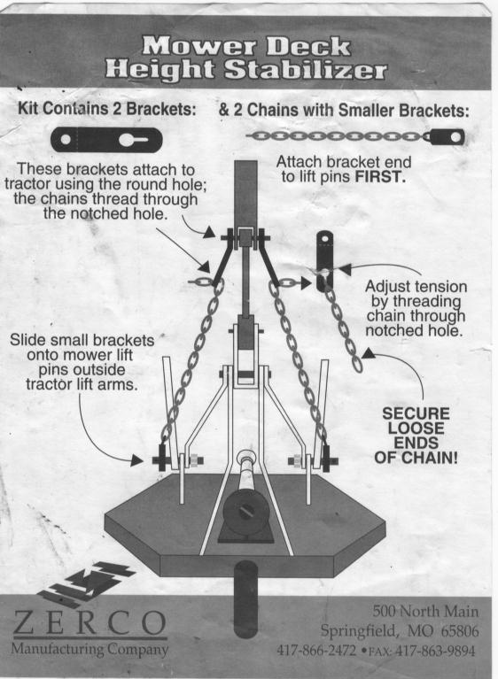

I found sets meant for old Ford tractors that run "limiter" chains from the top link attachment point on the tractor to the lower hitch pins on the implement- in this case my snow plow. You're suggesting I forego the top link attachment and use the triple mounting spot? That shouldn't be a problem as long as the angle of the limiter chains is steep enough to pull downward rather than back toward the rear too much.
Here's a pic of one of the ideas I'm planning to fabricate, but instead I'll try the lower triple holes.

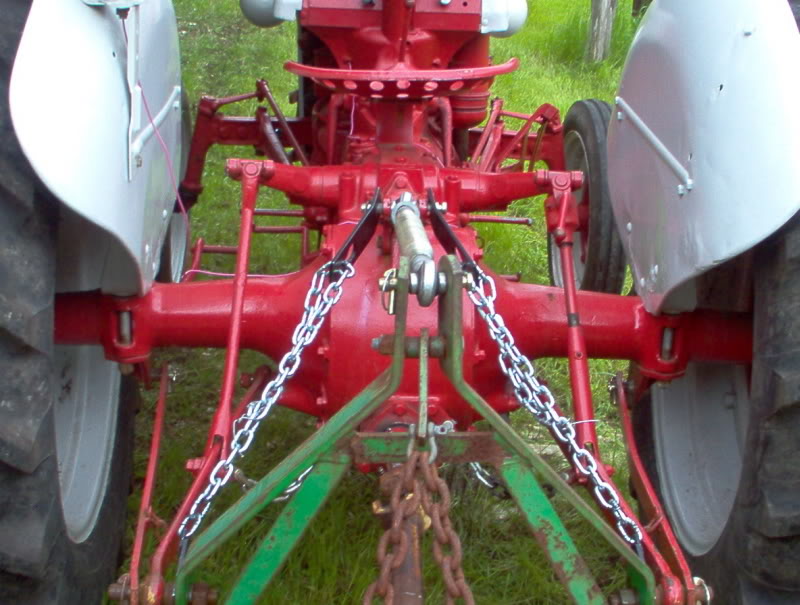

Regarding limiting chains: Something similar to what's in your pics would be great. A couple years ago when our first dam was empty, I was removing the built-up mud from our first dam while I had the opportunity. To aid stability as well as grip, I had my slasher (bush hog) on the machine along with several 6-8ft lengths of heavy channel-steel - off-cuts from an industrial shed construction site. I put as much weight as it would lift, and it made a huge difference. The down side was the hydraulics were working hard just to hold the weight up - I presume the 45-odd year-old seals aren't what they used to be! After a couple hours the gearbox casing would be so hot I couldn't leave my leg touching it. As a temporary and experimental exercise, I made a make-shift chain set like those in your pics, around each lift arm once just aft of the lifting link, and double chains up and through two large "D" shackles in the outer triple-mounts. I hooked the ends together using a grab-hook which allowed me to set the length appropriately, then I let the lift down so most of the weight was on the chains. Worked ever better than I expected. This gave the hydraulics a much easier time, and the gearbox was then getting nowhere near as hot. I wish I took a pic, but I'm sure you can imagine my set-up.
On the tractor in the photograph - looks like a TEA series Ferguson or a Ford 8/9N? - it isn't as much an issue because the design in the area is different. But on yours, mine and all others with the same assembly, that top link mount cannot take much force in any direction other than in a fore-aft direction. This is important Shaeff ..... they break because it is not what they were designed for - that is why the triple- mount holes are provided, and any genuine MF implements such as cranes etc, my post-hole digger (a great asset for planting out larger fruit trees, grape vines etc I must be lazy .... no, our ground is so hard and dry) mount there. But seriously, in this pic you can just see the area. Imagine the upward force at that point and you'll understand what I mean.

All very good points as usual! I'll definitely use the triple holes, I do agree there would be a LOT of force on the draft spring assembly with the limiter chains.
I grabbed some chain from the local hardware store yesterday. Tomorrow I'll fabricate some brackets to fit to the lower pins and to the triple holes. I'm going to look for a very long pin for those holes, or maybe a long bolt to mount the chain/upper brackets to.

Sounds good mate. If that pin is missing from your tractor, this is what you need (cheap as chips), with a standard lynch pin: S.71 Hinge Pin Also Item 3 in this pic: Bare Co - MF - Linkage Pins - Drawbars
Perfect, thanks! Just curious what the significance of the hinged pin is? Does the hinged design serve a specific purpose?
Edit- never mind, I answered that question myself trying to use a long bolt with the hitch at the wrong height haha. Makes sense now!
