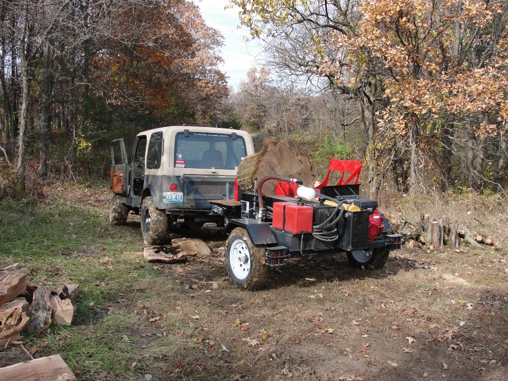

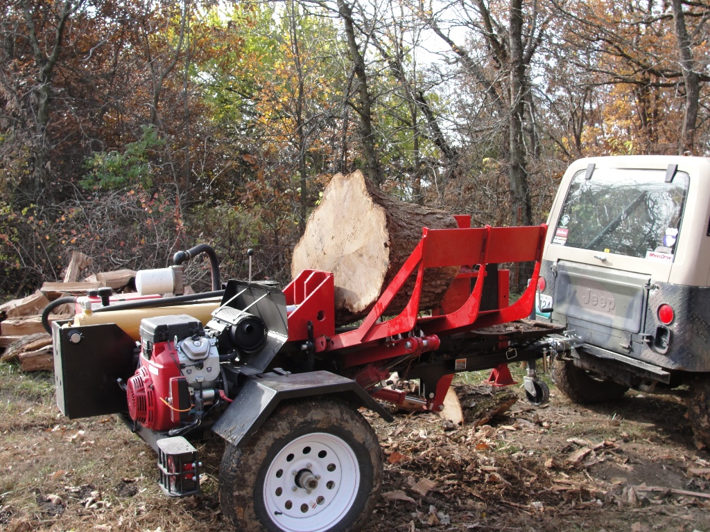

Now I use a trailer mounted splitter with a log lift. Some plus', some minus'. The 3pt was so convienent to get around in the timber with. Now I tend to bring the wood to the splitter rather than take the splitter to the wood as with the 3pt splitter.
