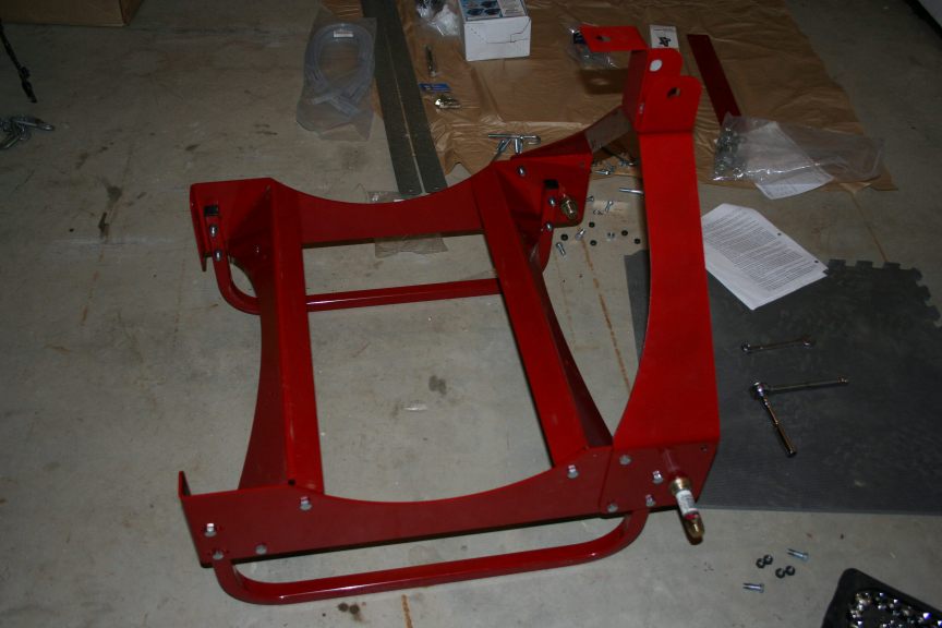

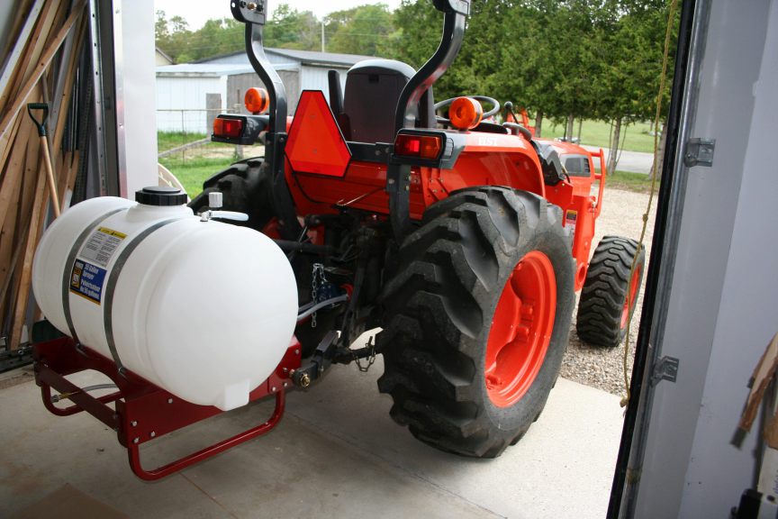

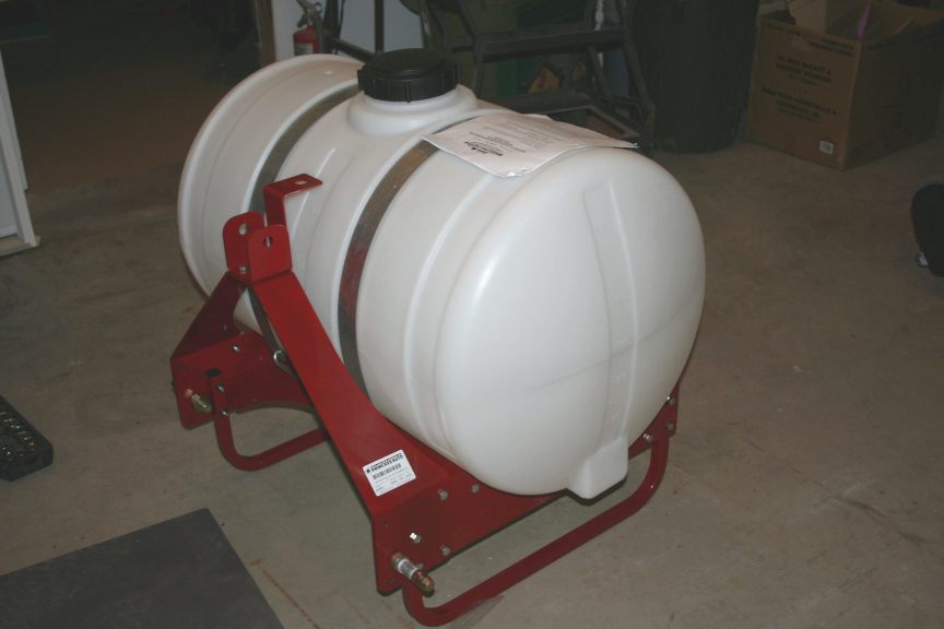

Here are a few pictures of assembling my new boomless sprayer.
sprayer-3.jpg - the frame assembly almost complete. Still a few bolts left to tighten.
sprayer-4.jpg - bolts tightened and 55 gal tank strapped in place.

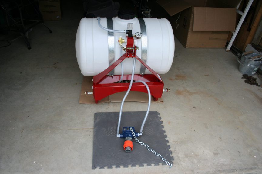

sprayer-5.jpg - With the plumbing complete and remainder of the frame in place ready to test for leaks.

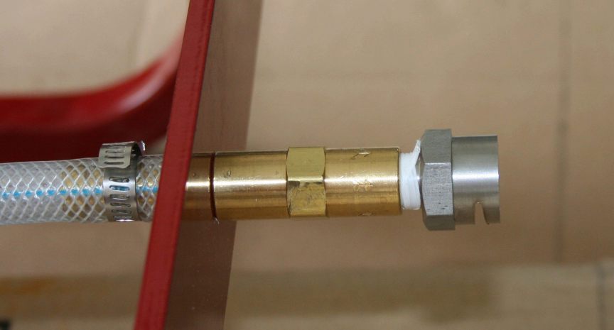

sprayer-6.jpg - here is a closeup of the boomless stainless steel sprayer nozzle and check valve. It should spray between 20 and 30 feet depending on pressure and the height of the sprayer.

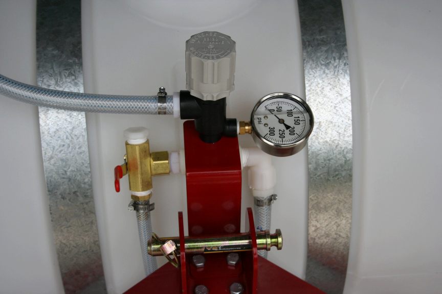

sprayer-7.jpg - here is a closeup of the manifold - pressure relief valve which controls the spray pressure and flow control valve which turns the spray off and on. I find the location of these valves a little inconvienient. I must raise the 3-pt to maiximum heigth in order to reach them while on the tractor.

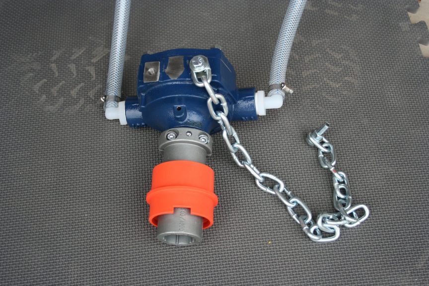

sprayer-8.jpg - The sprayer included a Delavan 6 roller pto pump and quick coupler. After reading the pump instructions I see the pump must be cleaned and oiled after each use so I am going to have to come up with a better way of attaching the pump to the sprayer hoses.

Thanks for the insight about the boomless sprayer and wind drift. A boom should be easy to make and attach to the sprayer frame if I decide one is needed. I just tested the sprayer with water and have yet to calibrate it.

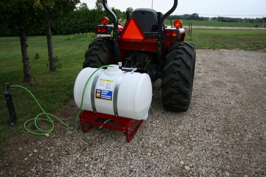

sprayer-9.jpg - sprayer ready to be tested on my tractor.
sprayer-10.jpg - filling the tank with water and checking for leaks. No leaks good to go...

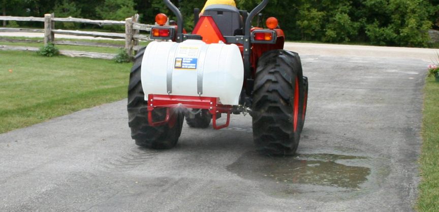

sprayer-11.jpg - testing the sprayer on the lane way. Sprays a width of about 20 feet at 30 psi. Just as my son and I started testing it started to rain. I'll have to wait for the rain to stop before I can check for how even it sprays.

I'll give the sprayer manufacturer brownie points for supplying a liquid filled gauge to dampen needle vibrations.
