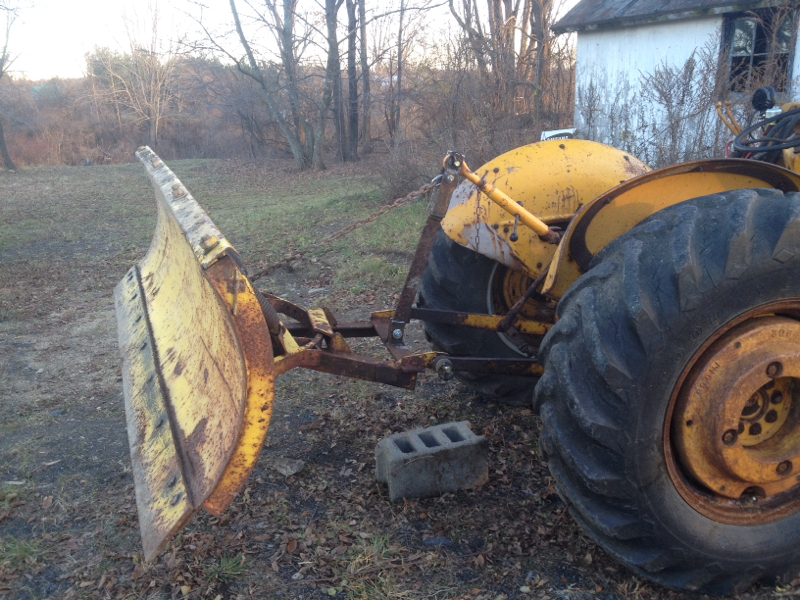

So I finally finished a bunch of pre-winter projects and had some time to think about mounting the stabilizer bars. Lo and behold, the holes for mounting the pins near the axle are too small for the stabs included in the kit. Looks like I'll have to drill them out to 3/4".
Oh well! On a positive note, I finally finished modifying the old snow plow to fit the 3pt hitch. Next, tire chains are going on. Already have an old set I got for free that don't even look used!
So, I need to grab a good 3/4" bit and hog out the holes a bit, then I can install the stabilizers.
Here's a few pics of the plow for your enjoyment. Total cost was for the mounting pins, so only a few bucks and a bit of welding.
