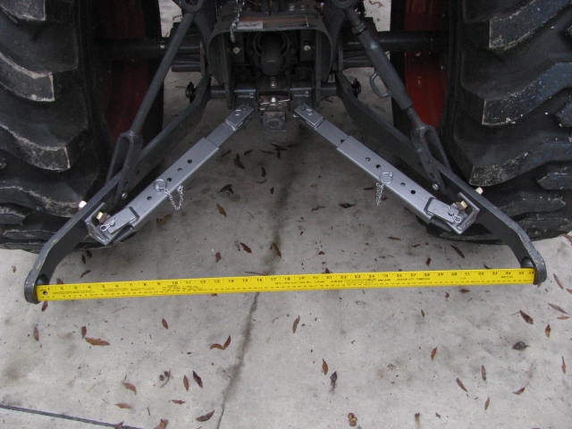

I have a new Kubota l5460 which I am loving.
Confess I am new to tractor world.
I am currently using a heavy box blade (with an OEM tnt)and when driving around on uneven ground with the blade up the BB can swing far enough to each side for the arms to touch the inside of each tire.
Is that something I should adjust away in the 3pt hitch itself? Doesn't happen often, but seems like it can't be good.
Just want a reality check for what is normal before I try to adjust it.

As you know, your L5460 is a Kubota 'Grand L' with pin adjustable stabilizers standard as part of the 3-Pt. hitch.
Lower the mounted Box Blade/3-Pt. until there is no/very little weight on the stabilizers. Pull the stabilizer pins. Lean on the Box Blade until it is centered, replace the pins with minimum slack side-to-side. That should do it.
You may have to rock the Box Blade side-to-side and pull/replace one pin a couple of times to reduce slack.
Do not lift your Box Blade too high when transporting it. Too high and the weight of the BB will make the 3-Pt slop to one side then the other side as you traverse uneven ground and tractor weight shifts.
If clearance is still insufficient I expect you can lengthen the Lower Links a notch or two to increase clearance. ( I have no experience with Kubota telescoping Lower Links.)

Ok, let me try... You do know that on your telescoping stabilizer bars, you will have a section that does not have a single hole, but an "oval" cutout to allow slack in the telescoping bar?.
You will have this on both bars, left and right. But if you want very little slack then choose a hole outside of this "oval" cutout area. On a box blade or some other implement you want very little movement side to side, and certainly never want it to touch either tire, do this procedure.
On level flat ground, raise the box-blade just off of the ground. Get behind it and look to see if it is centered down the center-line of the tractor. You will be able to swing it side to side a bit with your knee, but with the pins of the stabilizer bars in single holes, you should not be able to move it a whole lot. If it is not centered, remove both pins and push the implement with your knee or hands until it is centered and find the nearest pin hole that lines up and drop in the pin, and go to the other side and find that pin hole and drop in the pin. You may have to "jostle" the implement just a tad to get the pin holes lined up. The only reason I can think of for the box-blade to swing to the sides enough to hit your tires is that you have the stabilizer pins perhaps in the cutout area of the stabilizer, or have the implement on offset to one side.. A picture would help.:) I hope this has been of some assistance.

I am aware of the telescoping arms (which was one of the reasons I liked the Grand L) and the pin/slot option. I was assuming the pins were in the holes (not slots) but I guess I don't remember for sure and my pic makes me wonder. That would clearly be a cause of the behavior if in the slots.
Since it came from the dealer with the BB installed, I had assumed it was all set up correctly. But then noticed the major sway as I went over uneven ground with 1000lb implement raised.
The BB is mounted on the Cat II pins but there is still enough room if the 3pt was more rigid.
I'll check it out again this weekend.
