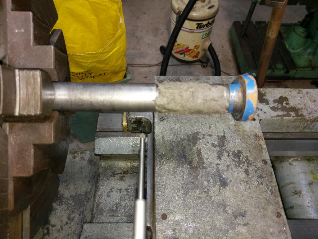

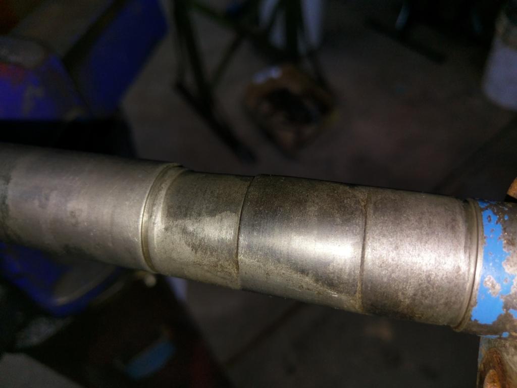

The brake & clutch pedal pivot shaft was badly worn where the clutch pedal pivots on it; I ground it down to fresh metal and slathered it with some metallised epoxy; I've set it up in the lathe and left it curing overnight.

That epoxy-coated pivot shaft will wear rather quickly; I'd weld that up, or make a new shaft.
