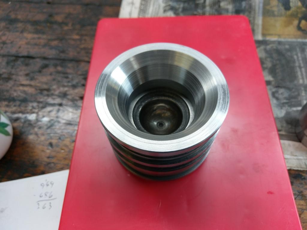

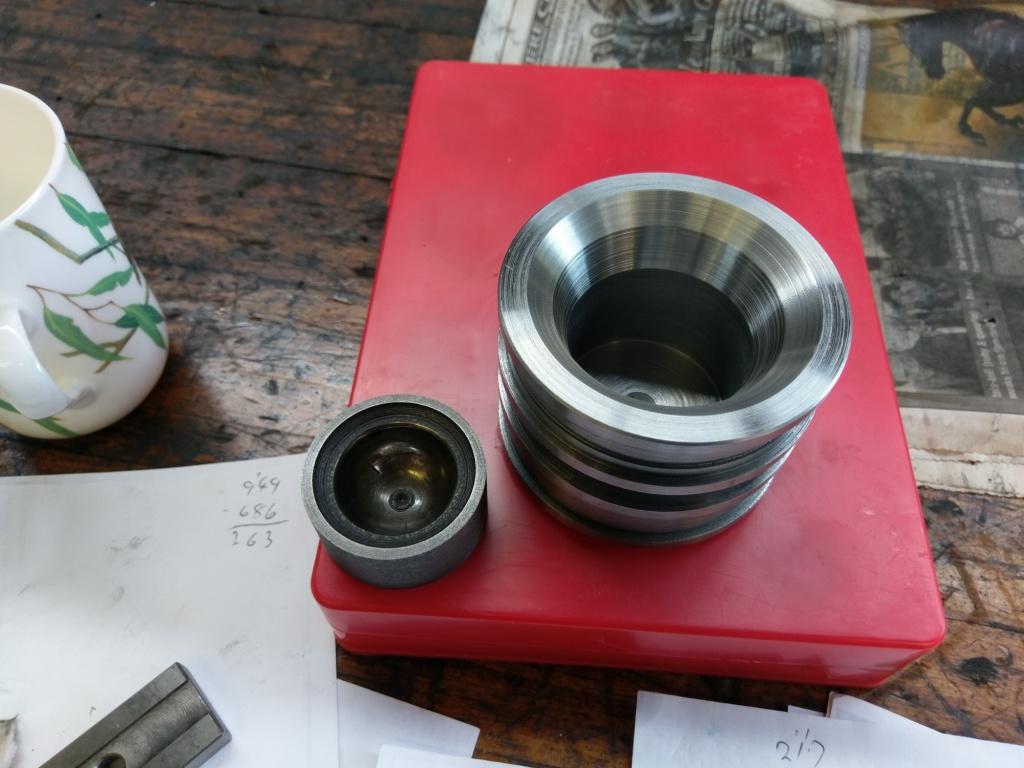

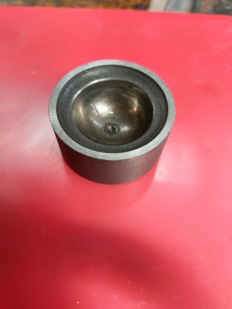

The cylinder has been honed to a very fine finish and is now round, straight and exactly 85mm inside diameter. I machined the old piston away to leave just the concave seat as a press-in insert, made a new piston to accept it and assembled the two parts. The new piston will take a modern single-acting piston seal, along with two wear rings, hopefully those parts will arrive on Monday. I picked up several boxes of other parts for the tractor yesterday including a new hydraulic pump, overhaul kit for the top cover, a clutch kit, power steering overhaul kit, the list goes on.
