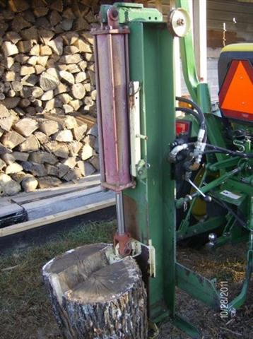

Send the pic to doug and he probably would build the three legs for a reasonable price - I dont remember anymore how much more I paid with the splitter - wasn't too much.
It's 3" x1" U Channel with 1/8" thick 4" sq plates on the bottom of each leg. Then the Y stand is 1" tube steel.

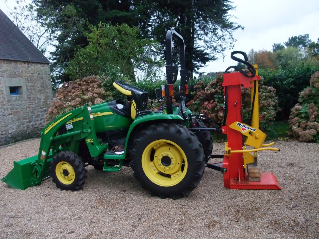

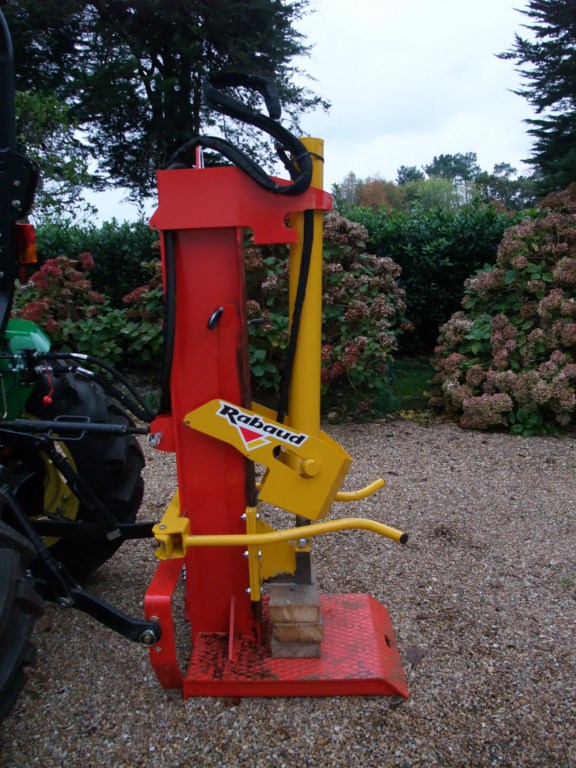

   / 3pt log splitter storage #12
With this vertical splitter, storage is no problem, when unhitched it stands firmly on any sort of surface. The ram can be unlocked and lowered so that you can clear doors and such.
