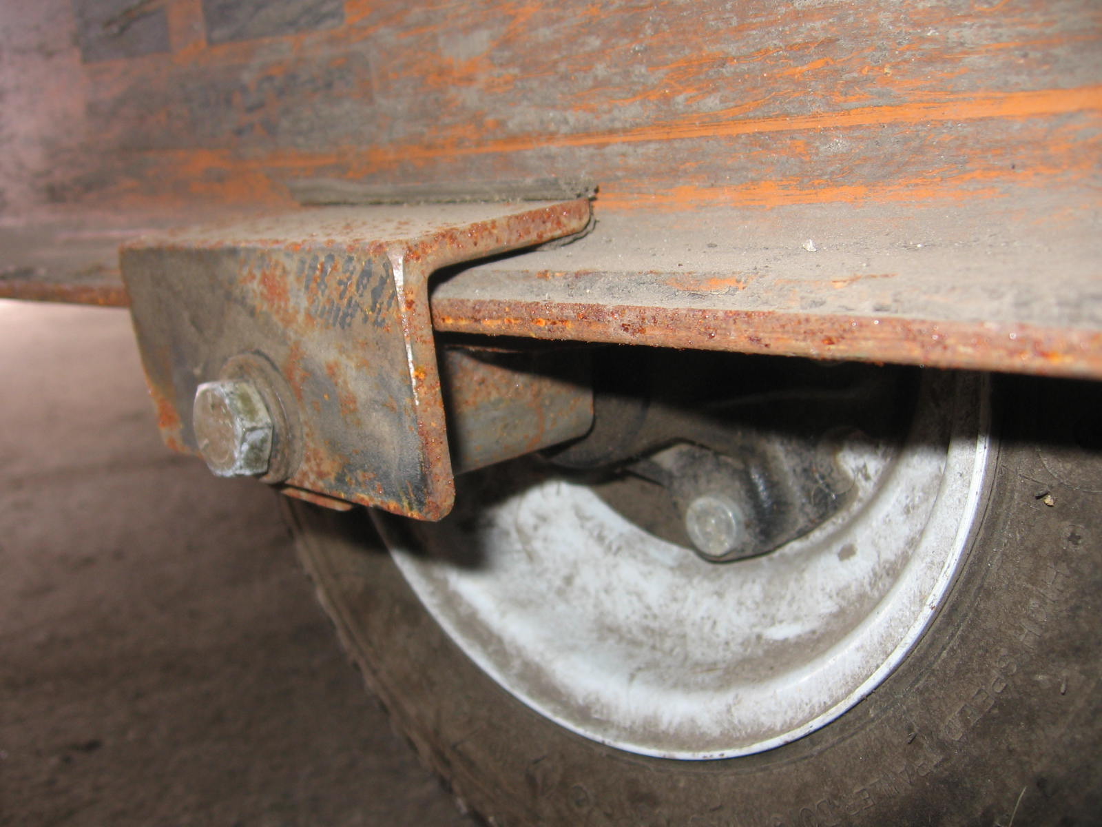

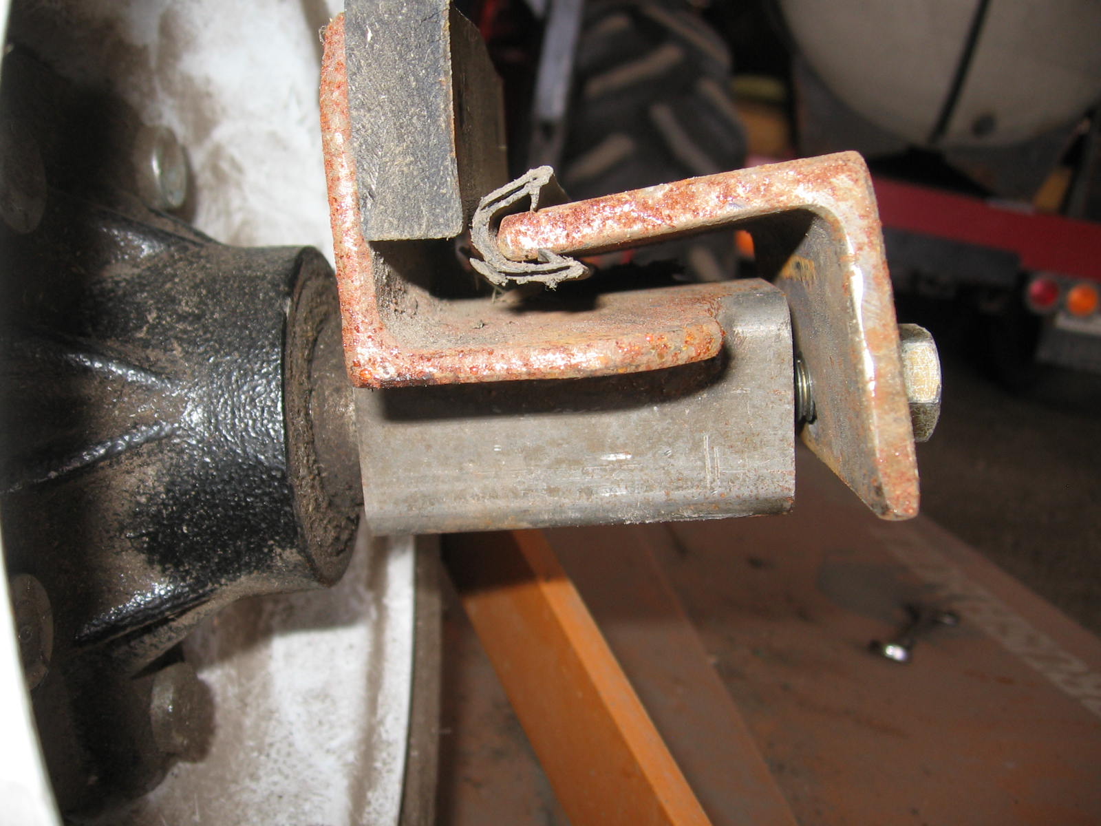

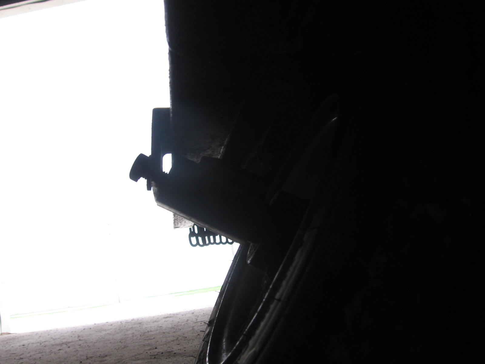

I have always enjoyed any ideas that simplify storage and mounting of implements. Built these wheel units to clamp on the edge of my 5' Woods mower . Makes it easier to hook up as you can just move it to the tractor . Also makes it nice to just roll over in a corner or out of the way. Found some cheap trailer axle stubs with hubs and a cheap set of boat trailer tires and wheels . Made them to mount inside the deck so it doesn't take up any extra width. IMG_3193.JPGIMG_3188.JPGIMG_3192.JPGIMG_3191.JPGIMG_3190.JPGIMG_3189.JPG

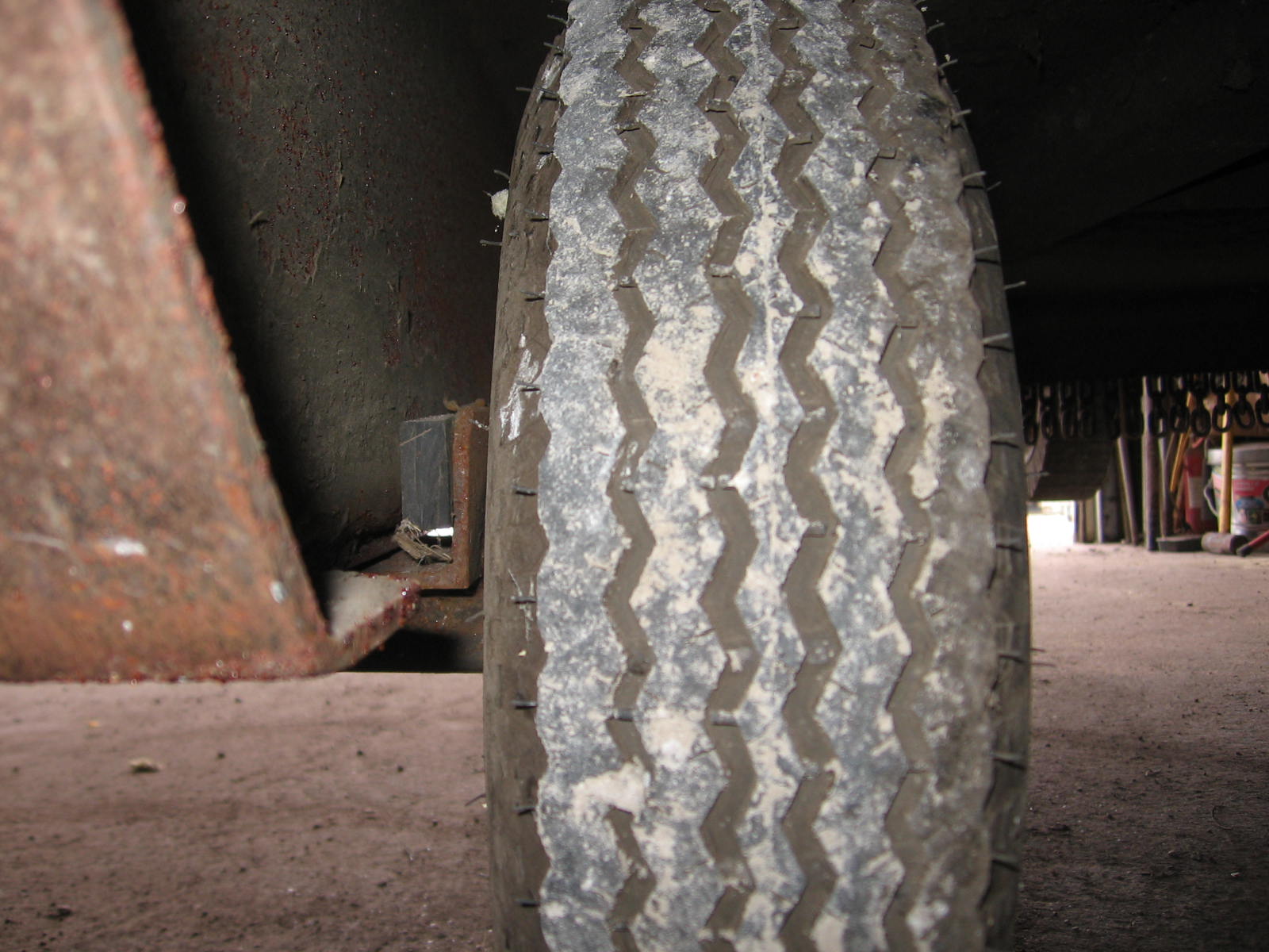

Neat idea. I assume this is a rough cut mower? What size tires are these to clear the underside of the deck in height?

I'll have to check in the morning, picture of the tires didn't turn out.

I have used snow plow dollies in the past . To many times had the mower slide off and drop down when on any thing other than a smooth concrete surface. These tires are 4.80/4.00x8 and between them and the tail wheel I can roll it most any where with minimal effort.

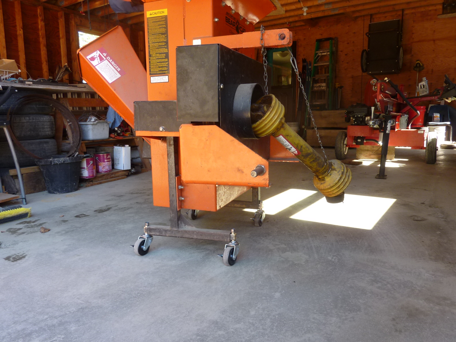

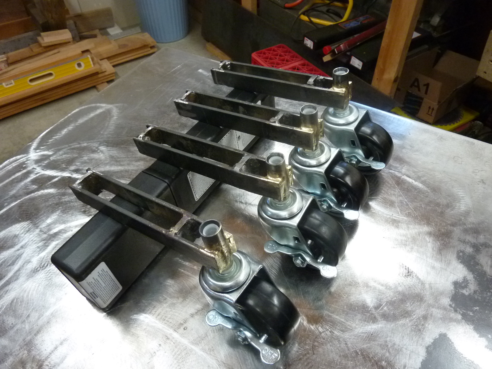

Good idea - I like those. Simple and single purpose so when you want your dolly to move something it is not under a tractor implement. I made a similar thing with casters so I could roll around and store my heavy chipper in a crowded corner. They just slide into the square tube frame.
