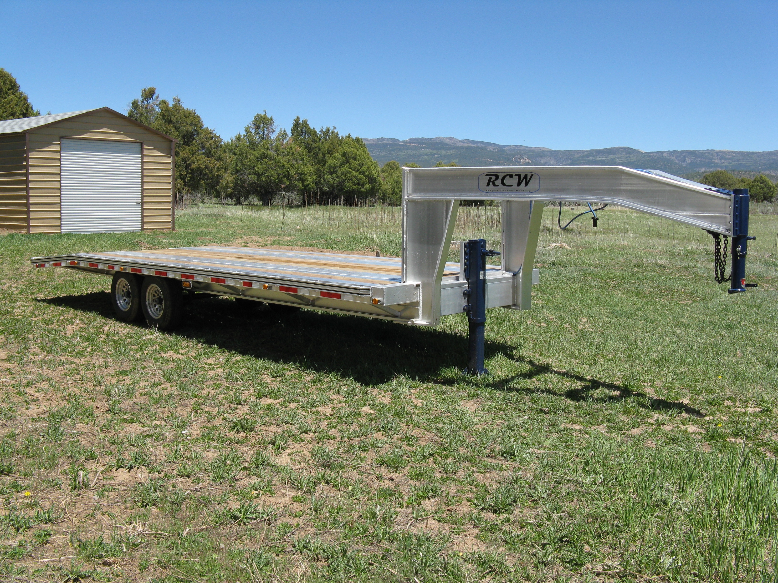

Yeah but the trailer weighs 8K plus. I love my 32 foot PJ hydraulic dovetail, but the trailers are heavy. Mine is rated at 22K and I am close to max when I put my 12K fire truck on it.
It's almost unavoidable to have a trailer with a higher load capacity weigh more, unless going with aluminum or a well engineered one. My 32' PJ weighed 10K, the 35' Diamond C weighs just over 8K. Both basically identically equipped.
A trailer's weight doesn't really bother me. If I want to move a vehicle that weighs 16-17K it takes a certain amount of trailer to do it. And with air suspension it doesn't matter if the trailer is empty or at max capacity, it still rides nicely.
The one I wish I had kept was a small one with 7K axles. It was very light, and there was room for a third axle to make it more useful, but I foolishly sold it for cheap.

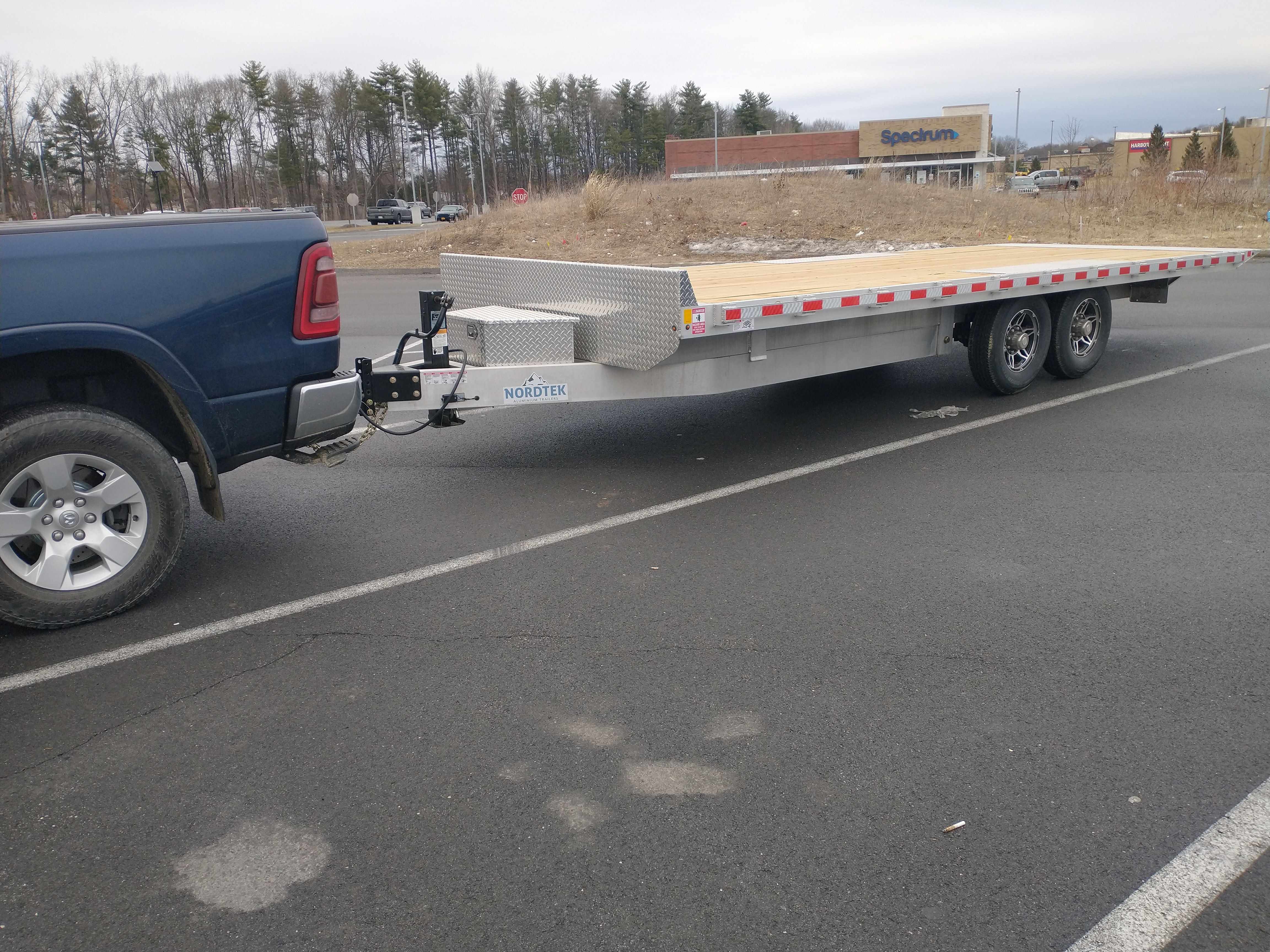

I finally broke down and bought a trailer this spring myself, got tired of borrowing trailers. I went with a fairly expensive trailer it is an Nordtek 14K aluminum 22 ft. deckover full power tilt, up and down.
I went aluminum as it takes away much less capacity from the truck, with an empty weight of 2900 pounds. Also the full tilt trailers have the axles further forward then ramp trailers, which I prefer as it's easier to center the loads over the axle.
Actually unless going deck over,a tilt trailer meant for car hauling (most of them) will have the axles set way back to facilitate exiting the vehicle. Only drawbacks to that are more tongue weight and more cheating on cotners. Also a little bit harder to back into some locations If loaded right on the right tow vehicle hoever, this can make for a more stable and enjoyable experience on a long highway trip. A longer hitch on the truck side coupling can help remedy some of the above.
Actually when I was shopping even the tilt bed equipment trailers have the axles much more centered then the ramp trailers do.
These are full tilt trailers as I had absolutely no desire for a partial tilt.
