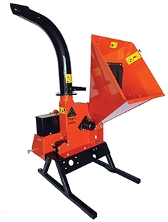

I'm sort of partial to the 3pt chipper, myself. For us, anything over 3" is firewood.
What I like most about it is that, after I added a drawbar & trailer hitch, I can drive around to wherever the limbs are, chip them and have the chips blow right into the attached trailer. Aside from greatly reducing the brush piles, the chips have become a welcome, "free" landscaping material.

When I moved to this property 4 years ago, I bought an 8hp chipper/shredder. I don't recall the brand name, but it was a rental unit at a local tool rental and is pretty heavy duty. I needed/wanted something bigger though and after I bought my Deere 3520, I decided to get a PTO unit. I read all the reviews and decided to go with a non-Chinese unit although one of the Chinese units is often mentioned on here and gets rave reviews. Anyway, I started shopping both locally and using SearchTempest.com to scour Craigslist on a national basis. I found a few contenders and ended up with a Bearcat 73554 Chipper/Shredder that I found in WI (I'm in OH). Got it here, used it, LOVE IT!!
It's great to trim up brush around the edge of the yard and just chip it up so it's gone. I've run 4-5 inch stuff through it and it takes care of it with no problem. It's a manual feed unit, but once you've man-handled the material up into the feed chute, it pretty much feeds itself. The shredder takes care of all of the little stuff - just put it in the chute and it sucks it right in. The only "problem" that I've had is if I have a long (8' and up) piece that's at the high end of the thickness scale (4"-5"), it will start to bog down towards the "end of the grind". My solution is either to cut it up into smaller lengths or feed it and pull it out before it bogs down.
Overall I'm super satisfied with my decision to buy one. But, as oosik points out, these units will work you - at least mine works this old, gray haired fat guy! :) This past summer my very in-shape brother in law was visiting and helping me with some stuff around the place. We both were cutting and feeding the chipper hard for about 1.5 hours. Cleared a lot of brush, but we were both sweatin' like pigs when we were done. My point of this is that, as others have pointed out, feeding a chipper is not an easy task.
I rented a self-powered, self-feeding, tow behind unit many years ago to take care of some brush at my old house. I would advise that you rent a unit like that to see how much work it is to chip up wood. It might also lean you towards either burning (as many have suggested) or buying a self-feed Woodmaxx that many on here seem to like.

I got sick of burning brush and orchard prunnings and bought a Woodmax hydraulic feed and am really glad I did. I have run large single axle gas and diesel powered commercial chippers a lot over the years. The beauty of a chipper besides the material you get is simply the space reduction. And you handle it once. Pick it up, shove it in to the feed rollers and it is done. Packing and stacking is the PIA I don't miss
