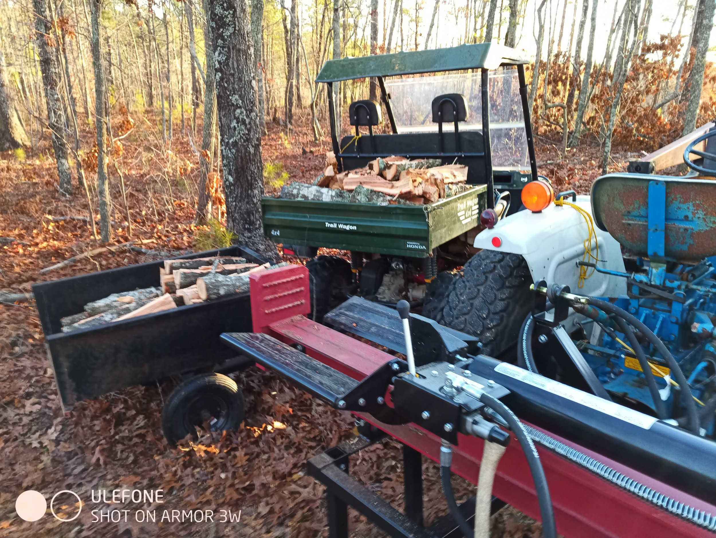

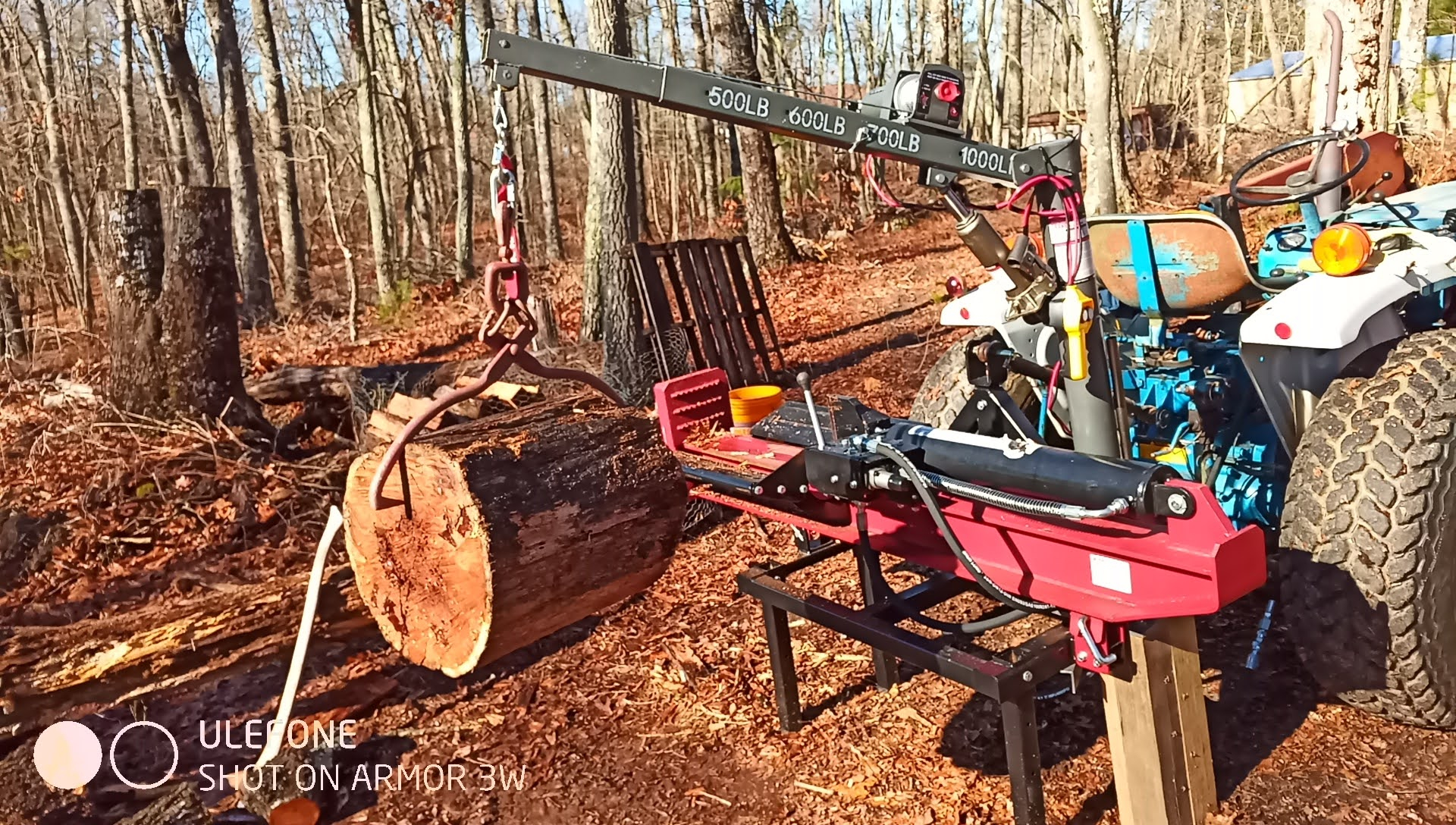

I had to get a new splitter last year and decided on a 3PT simply because I didn't want another small engine to maintain. I ordered a BOSS 22 ton through Lowes. It can go horizontal or vertical and has an auto return on the ram. Website said it came with 1/2" NPT thread hose, but they weren't NPT. I've got it setup so I unplug the FEL and then plug the splitter in. That way the fluid flows freely to the splitter decreasing the heat buildup.
I typically drag the logs to a central area, cut them and then split. If I take the splitter to the tree, then I load directly into the UTV.
On another note, I added a lift and electric winch to lift the rounds up. And I have a second tractor that I use to drag logs with.
But as others have said, your tractor's flow rate will determine if you can use a 3PH hydraulic splitter. Mine has 8 GPM. Not super fast, but fast enough for me.
