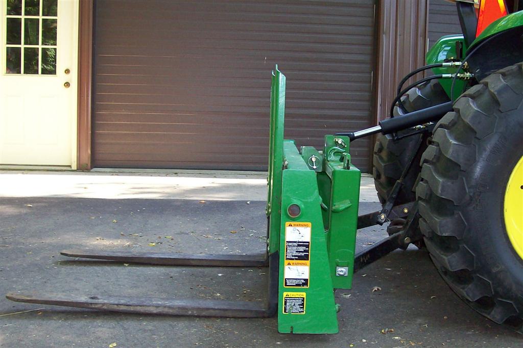

I also use my Deere forks on the 3 ph iMatch. Having the hydraulic top arm is almost a necessity to be able to pick up pallets with the forks on the 3 ph. Also, the top arm when retracted makes reaching the lockdown levers so much easier to reach from the tractor seat, making it easier to just stay seated while exchanging attachments.
