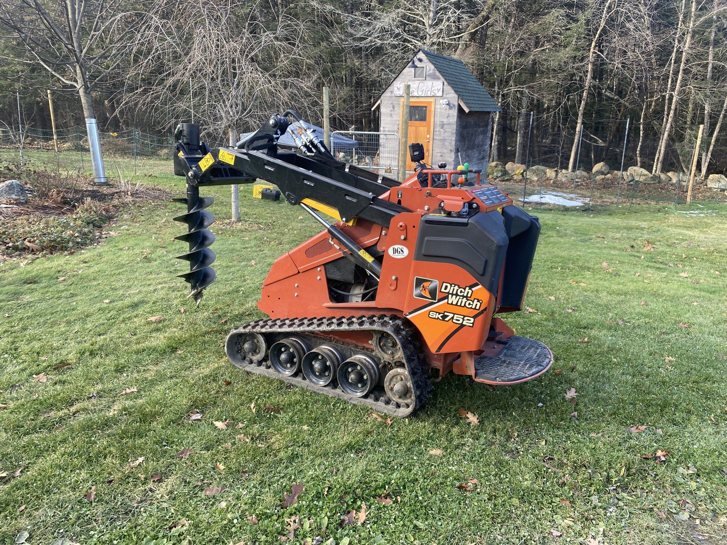

Find a friend with one of these !

Wow that ditch witch seems really nice.

For the pole barn posts I'd definitely rent a skid/ctl with an auger; you'll likely need an extension and that's a real hassle with anything else.
I have a phd for my CUT but I needed to drill some 12" x 60" deep holes when I set up a ground mount for a solar array and in our summer hard clay it would've been a total no-go with the CUT -- the skid was brilliant as it has serious down-pressure (though on a couple holes I hit a huge rock that was thankfully only 4-6" thick but that was still a digging bar + sledge hammer. We expected the day to be max 2h of drilling holes but we were there till midnight lol)
I doubt you'd be turning a sufficiently wide auger with anything else for planting trees to be honest.
For only occasional post hole use, I'd go manual; if you think you'll be doing 10 a year or you have terrible soil, maybe get the phd.
Knowing what I know now, I could've rented a skid + auger for my fence posthole jobs and a couple other jobs where I had more than a few holes to put in; I'd've had straighter holes put in much more quickly and I'd still have money left over, seven years later, though not that much. Close to a toss-up whether it's been worth having (unlike pallet forks, for instance, which are used a ton).
