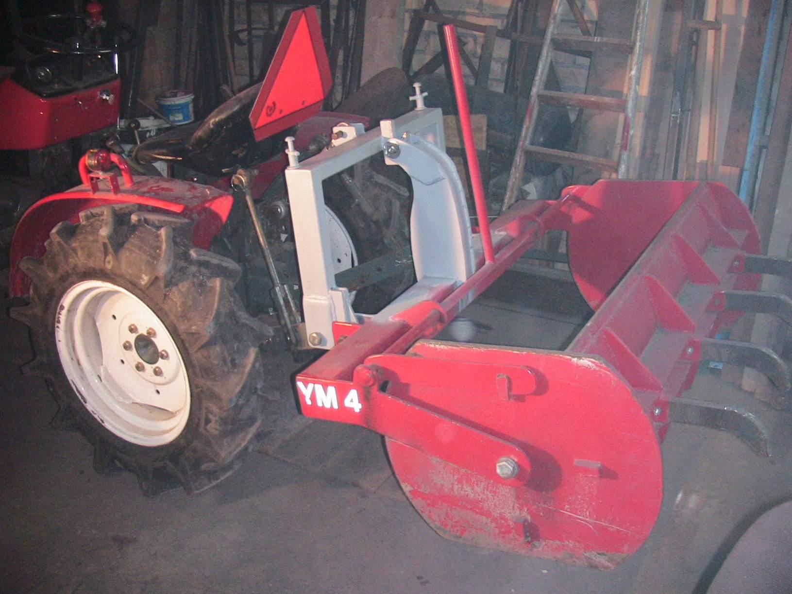

Quick Hitches are just coming available here, but I wanted one so I ended up making one for my self. I have used it a lot since I made -- it is always on the lift except when I am using the tiller (2 point). I had to conform my home made implements to my new standard, but it is so easy now to change implements that is far and away worth it. My tractor is small enough that I can man-handle most of my implements, but now it is so fast to change implements that I can use the right tool for the job instead of the "one on the lift." :thumbsup:
pictures of my hitch and the mods that I made are linked in my signature.
