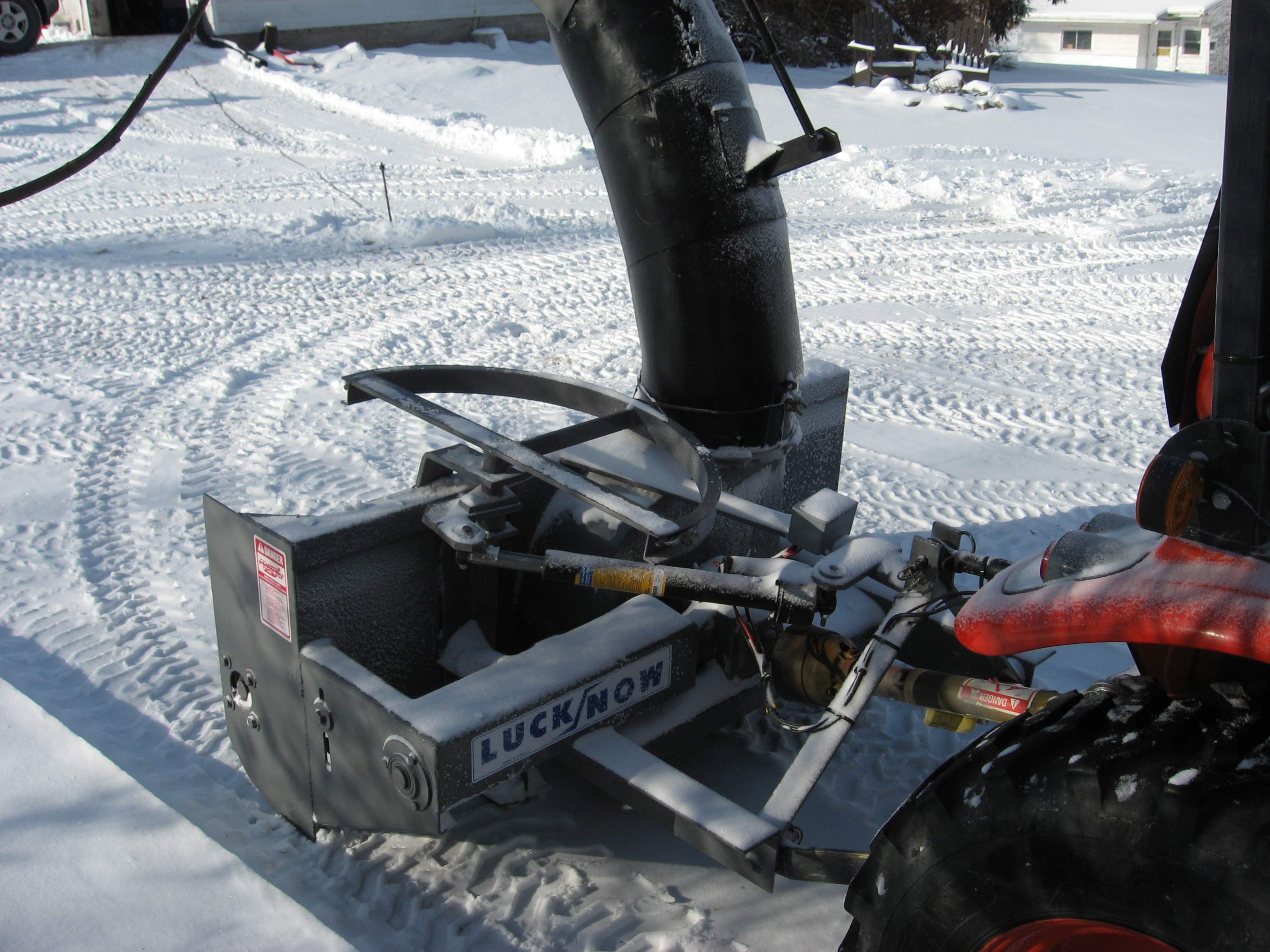

I was wondering what's the proper way to have a 3pt snowblower adjusted. By adjusting, I'm refering to the angle of the snowblower as it sits on the ground as controlled by the top bar (that screws longer or shorter.)
I originally tried having the snowblower sit level on the ground. What I find is that the snowblower leaves 1/2" or so of snow. If I readjust it so that its angled slightly lower in the rear, I get a clean scrap as I snowblow. I'm worried about wearing something out faster than normal using it at this (small) angle. Note that my snowblower doesn't have an adjustable scrapper bar underneath the way my old walk-behind Toro did.
Any opinions?
FYI: I have a 5' Farm King blower on the back of a Kubota B2710. The manual that came with the blower is no help in about this.

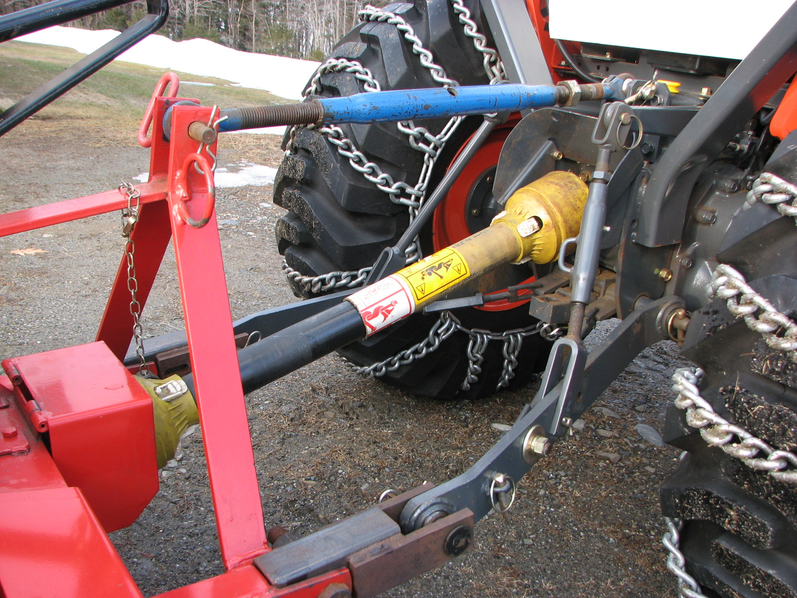

I had that knuckle knocking problem with my B7800 and Puma 64 snowblower,
when snowblowing down steep sections of gravel driveway.
I not only could hear them knocking, I would feel extreme vibrations too.
As I'd back down these steep sections, the leading cut edge of the snowblower would dig into the gravel. To stop this, I would shorten the top link, but that increased the angle of the PTO driveshaft to the point of knuckle knocking of the universal joints.
To decrease this driveshaft angle I eventually added 6 inch extension mounts to the snowblower, which resulted in a longer top link and longer driveshaft to be added too.

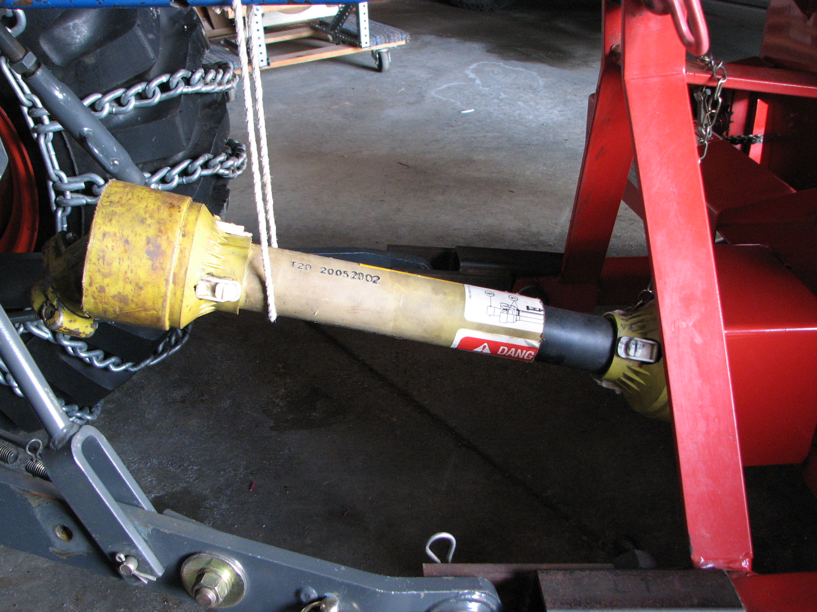

DHD, that driveshaft is scaring me. Are you sure you have enough overlap?
/ 3pt Snowblower - Adjusting #16
The overlap of the shaft is good, but from what appears in the picture I can understand the concern.
When the shaft is moved inward and bottomed out, the outter plastic shaft is 3 inches from bottoming out.
I have been snowblowing my 530 foot driveway and my neighbors 100 foot driveway for the past few years with this driveshaft.
I had my dealer make me a longer shaft when I added the snowblower extention mounts.
The dealer just used the same plastic protective housing that was on the original, shorter shaft.
