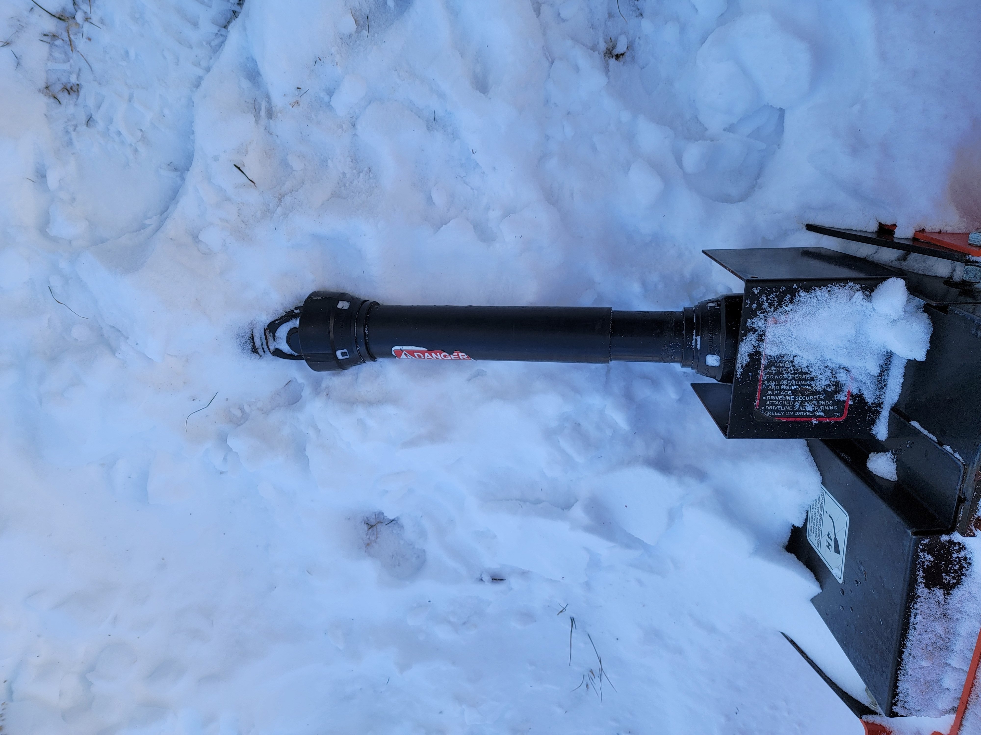

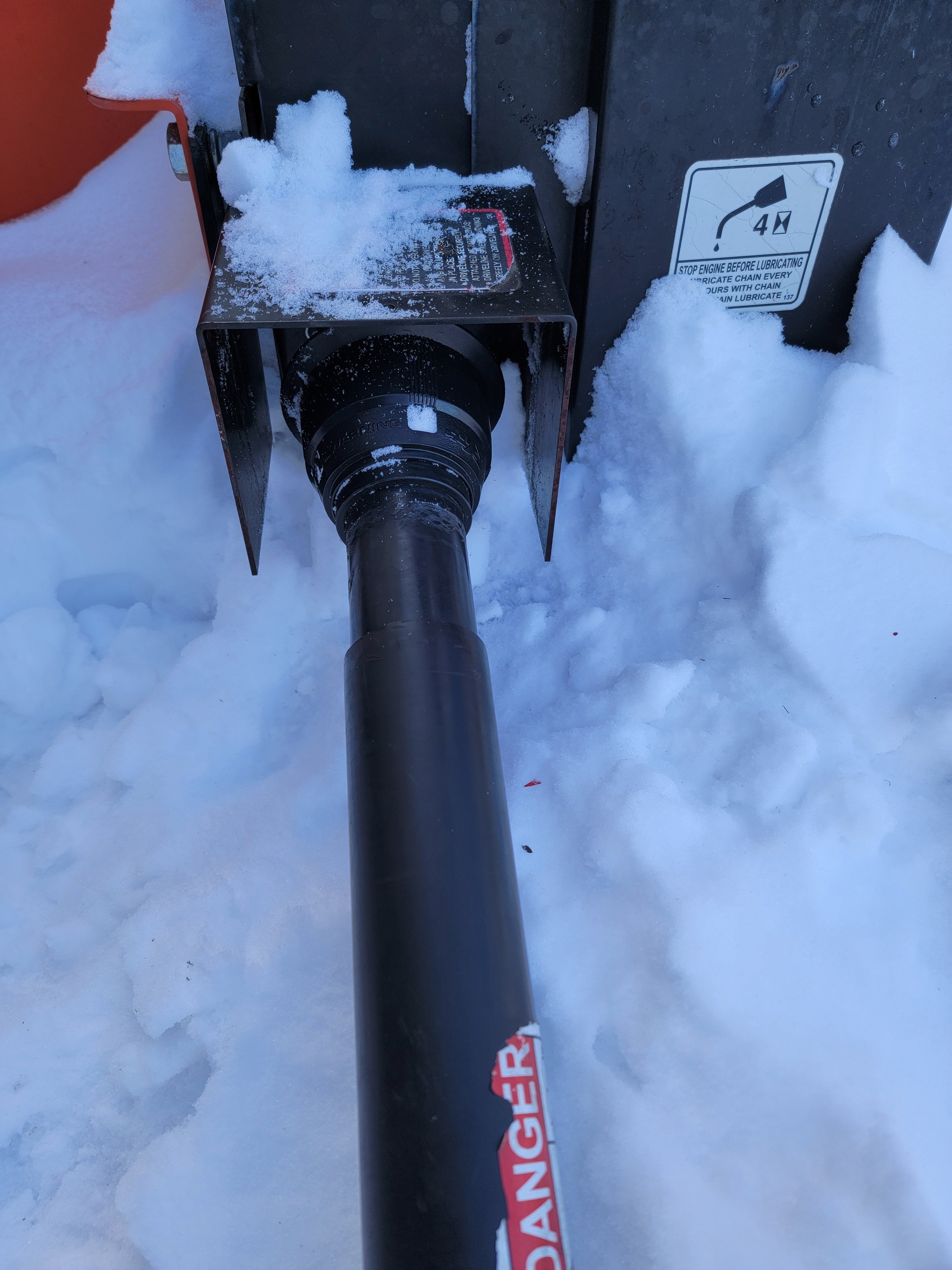

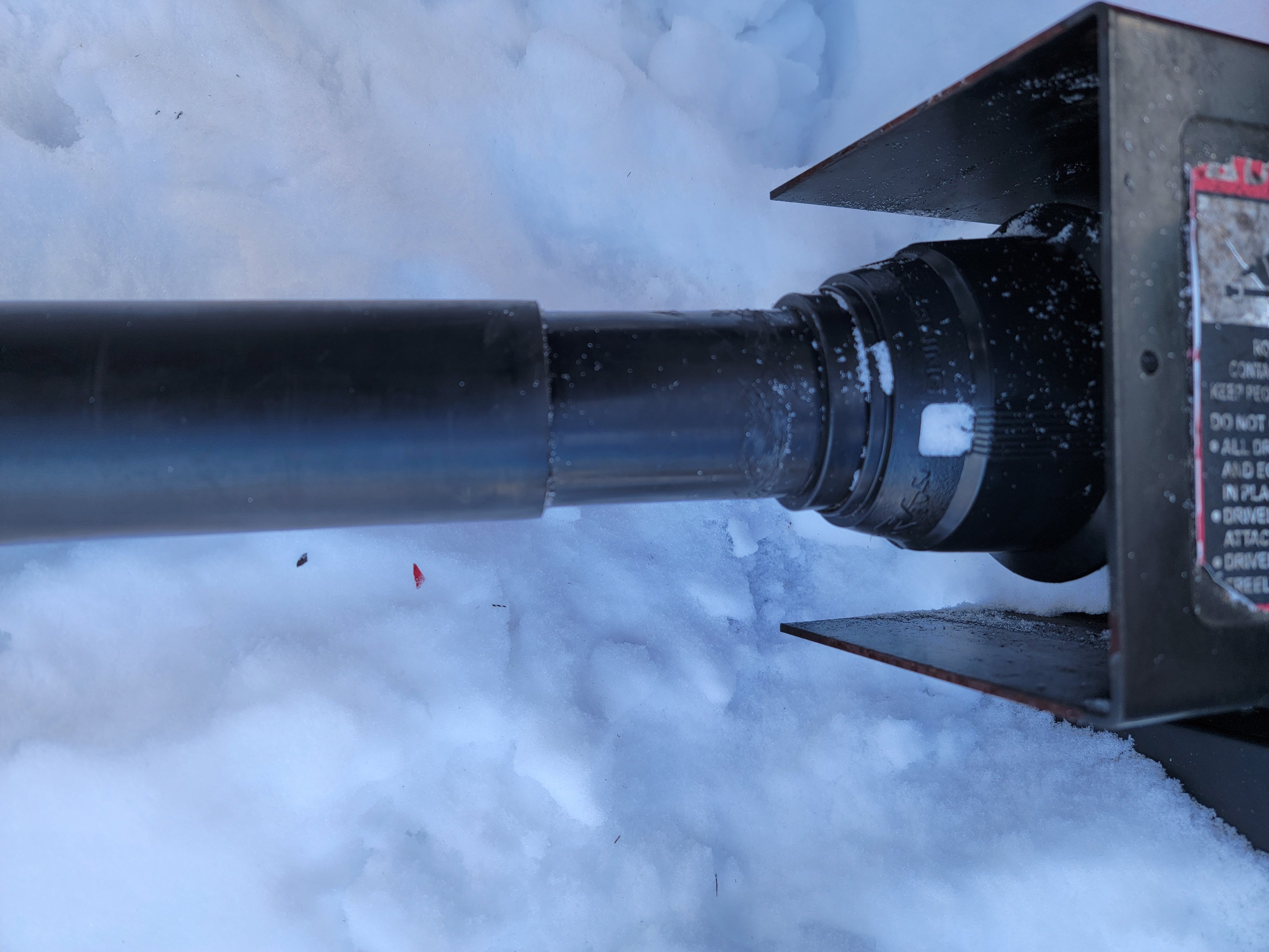

/ B2782B Front Snowblower Mounting Problem
Are both ends of the short shaft connected when you have the problem? Try disconnecting the other end first and then try to remove the short shaft at the blower. If you get it apart, try connecting the short shaft at the blower first and then connect it to the other section.
Yes, that's my problem.
Both ends are connected.... and stuck. They won't move so I can't couple the splines of the shaft to the mount/sled.
The pictures don't help a whole lot as the shield are in the wa yof showing the ends of the couplers.
But both ends that mesh together are a rectangular hole. (Male & Female).
We jammed them together, and now they will not come apart.
Used WD40, Lube-Blaster but they are still stuck.
If I can figure out how to disconnect the one part attached to the blower, it would help a lot. I can take it to the dealer for him to get it apart.

/ B2782B Front Snowblower Mounting Problem #6
Use a wedge and gently tap them into place first one side then the other or both at the
same time
willy

/ B2782B Front Snowblower Mounting Problem #10
So the blower and front two pto peices are not mounted to the tractor and subframe? Do you have a jackall? Try and lash one end of the pto to the jack the other end against the blower and then use to separate them?
Initially I was thinking everything was attached to your tractor and subframe but the photos show otherwise.
The two PTO shafts are connected to each other (jammed) and attached to the snowblower, but not to the subframe.
I tried pulling them apart, tapping them apart, and spraying them with a penetrating oil.
Nothing seems to be able to get them apart.
I still need to see how to remove the PTO shaft from the Snowblower so I can just take the two stuck pieces to the dealer.

/ B2782B Front Snowblower Mounting Problem #14
Can you roll the snowblower over far enough to see the bottom side of it? That way, you or someone here, could probably figure out how the pto shaft is secured to the snowblower
#18
It's 400 Lbs so not easy to flip it. I will have to wait for some help.
In the meantime, someone told me that there is a bolt that secures the shaft using a compression collar and a keyway pin held in place with an allen screw.
If I can figure out how to remove that metal shaft guard, it would be a lot easier. From the parts diagram, it looks like just some nuts/washers hold it in place.
#19
Hi All. Once again, THANK YOU ALL for the help, support & Guidance in my quest to separate the two PT shafts.
It's been cold and rainy here the last week, so I didn't really have a chance to work on this problem. I did move the snow blower to a different loaction, then dismounted the "Sled" from the tractpr so I could mount my FEL as I would need it to load the blower on a trailer (if I had one) to take it to the shop.
After I moved the blower to a slightly better location to work on it, the first thing I did was try to release the Shaft Guard(s).
NOPE! feel like a complete idiot, but I could NOT see how to release the shaft guard. If I could to that, I could not move it over the universal joint, but it would allow e to better squirt my liquid wrench into the stuck parts.
SO I just blindly squirted the parts with a healthy amount of Liquid Wrench.
Next, I thought I would release/detach the female PTO portion from snow blower. How hard could that be?
It's a tight area, but I did manage to get the thru bolt and nylon nut removed. OK... I figured the rest would be easy. NOPE !!!
I was unable to remove (or even loosen) the set screw. I sprayed it liberally with Liquid Wrench too, but to no avail.
I actually bent my allen wrench trying to loosen it. I gave up any further attempts in fear I would strip the set screw.
What now??? I came up with the bright idea to hang the blower up in the air (just a few inches) by securing a chain thru the Universal joint to the male end.
Then hung it in the air using my FEL overnight. (Of curse I gave it a few more liberal sprays of Liquid wrench.)
While it was hanging, I tried whacking the shafts with a board in hopes the vibration would help the Liquid Wrench soak in, and maybe even cause the parts to separate. No luck.
The next day (Today), I sprayed the parts again as best I could, and whacked them some more.
As a last resort, I tried using my FEL to raise and lower the blower , rather forcefully (read "jerking action"), and prayed they would come apart.
SUCCESS !!!! They separated.... YIPEE !
