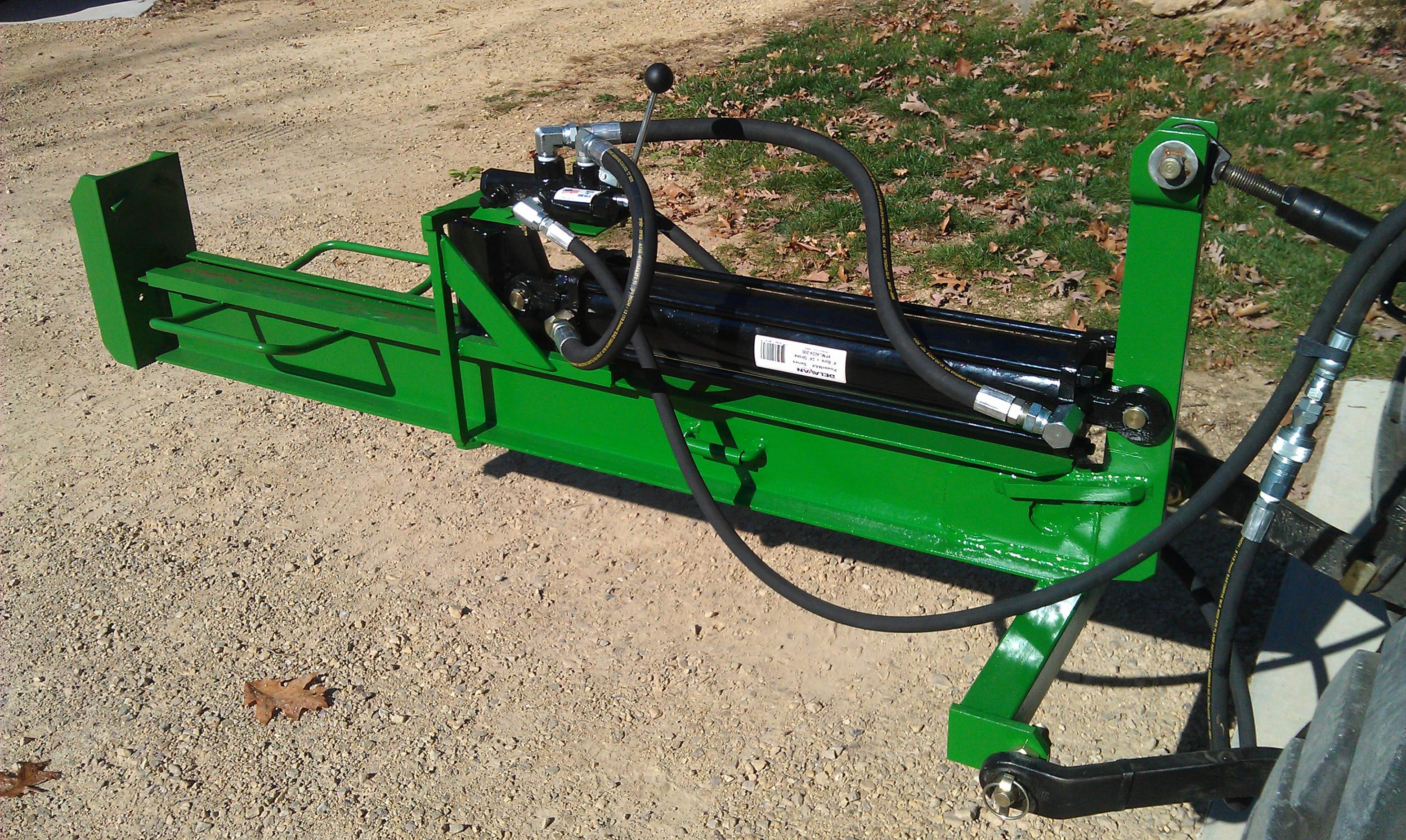

Here is the one I made 2 years ago. It works for me because I only split about 2 cords a year and it is usually from some dead fallen tree in my woods on the side of a hill. I like being able to maneuver through the woods and back right up to my wood then use the top and tilt to keep it all level. The other thing I like is that I can just lower the 3pt and roll big logs on.
forgot to mention it has the prince re-gen valve on it and that makes all the difference in the world on speed.
Different strokes for different folks.:thumbsup:
