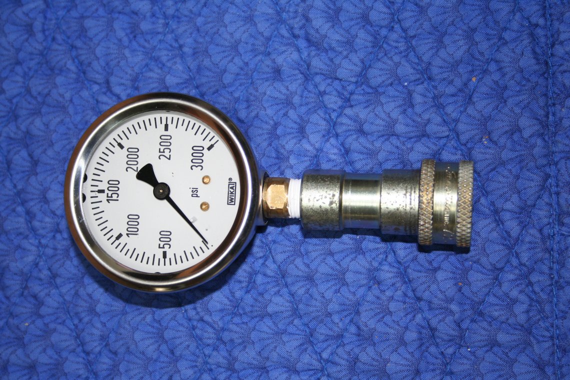

A hyd gage test set like this should only cost about $30.
The gage should run about $10 to $15, plus the 1/4 in QD set, short hose , and a tee.

J J, thanks for the tip. I'll get a hold of a gauge. I will just need to figure out where to tap into my hydraulic system. I guess that is not really a general hydraulics question since that would be specific to each machine.
I have quick disconnects for my FEL, but since everything else still works without the FEL attached, it seems like those connections are not in the power beyond circuit, but maybe behind some kind of priority valve. I'll take a look and see where I can tap in.

If you want to monitor the complete hyd system, install the gage or a QD coupler at the IN port of the FEL valve in a tee. Then any hyd being operated will reflect the pressure used, on the gage.

The lines that run from the HST to the FEL valve are all rigid pipe. I don't think it would be easy to tee into that without bending the tubing.
Instead of that, I'm thinking that I can rig up a bypass hose that I can use to connect between the two quick connects for the FEL lift cylinders, then tee into that. To do the pressure test I would just need to hold the FEL joystick down or up. Does that make sense to you?
Thanks again for your help.
-Rob
/ 3PT squeals on partial raising #14
By plugging into the FEL QD, you only test the FEL relief.
If you install a QD in the IN port of the FEL in a tee, you test the tractor hyd circuit. Any valve that is activated.
