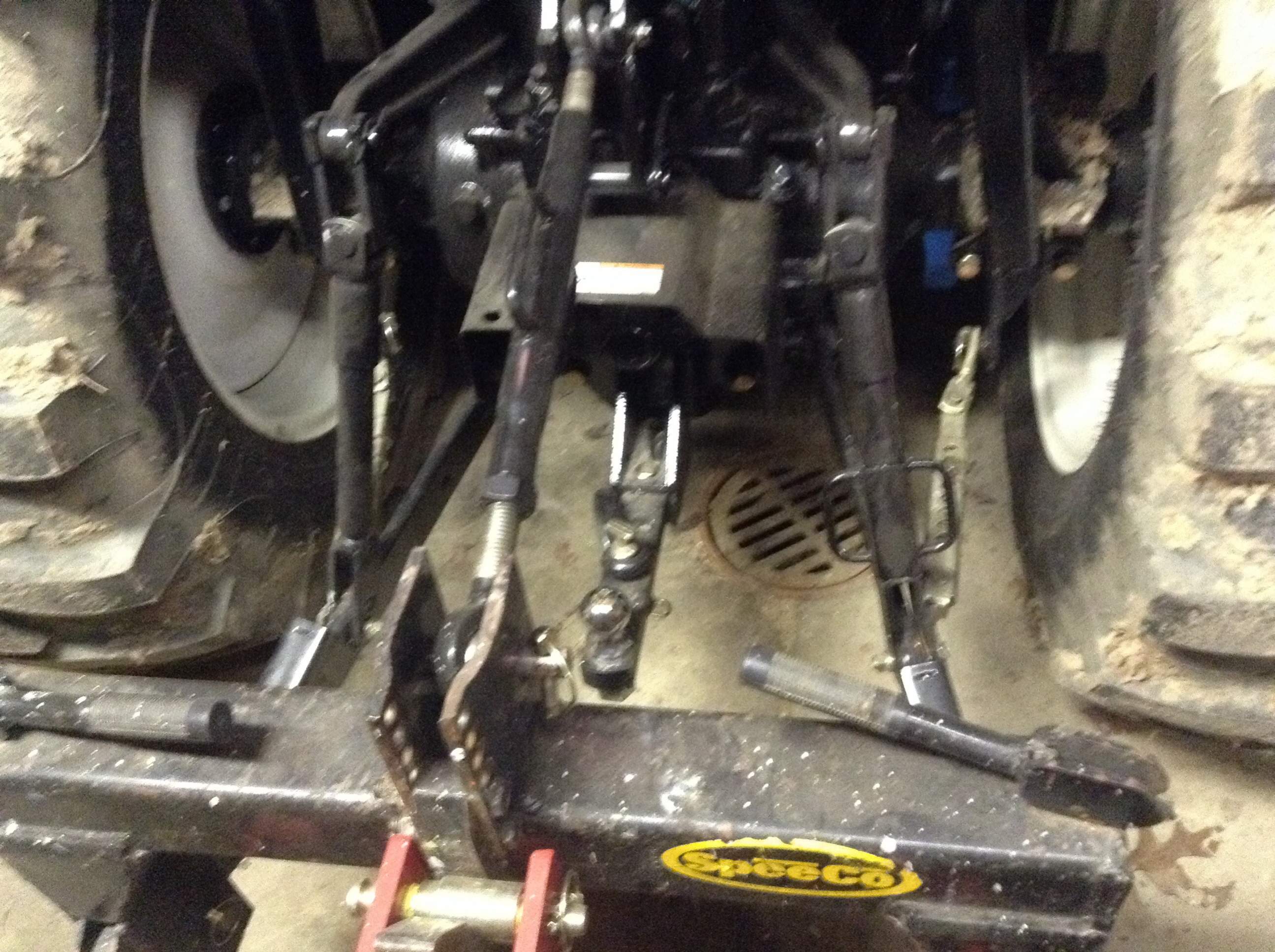

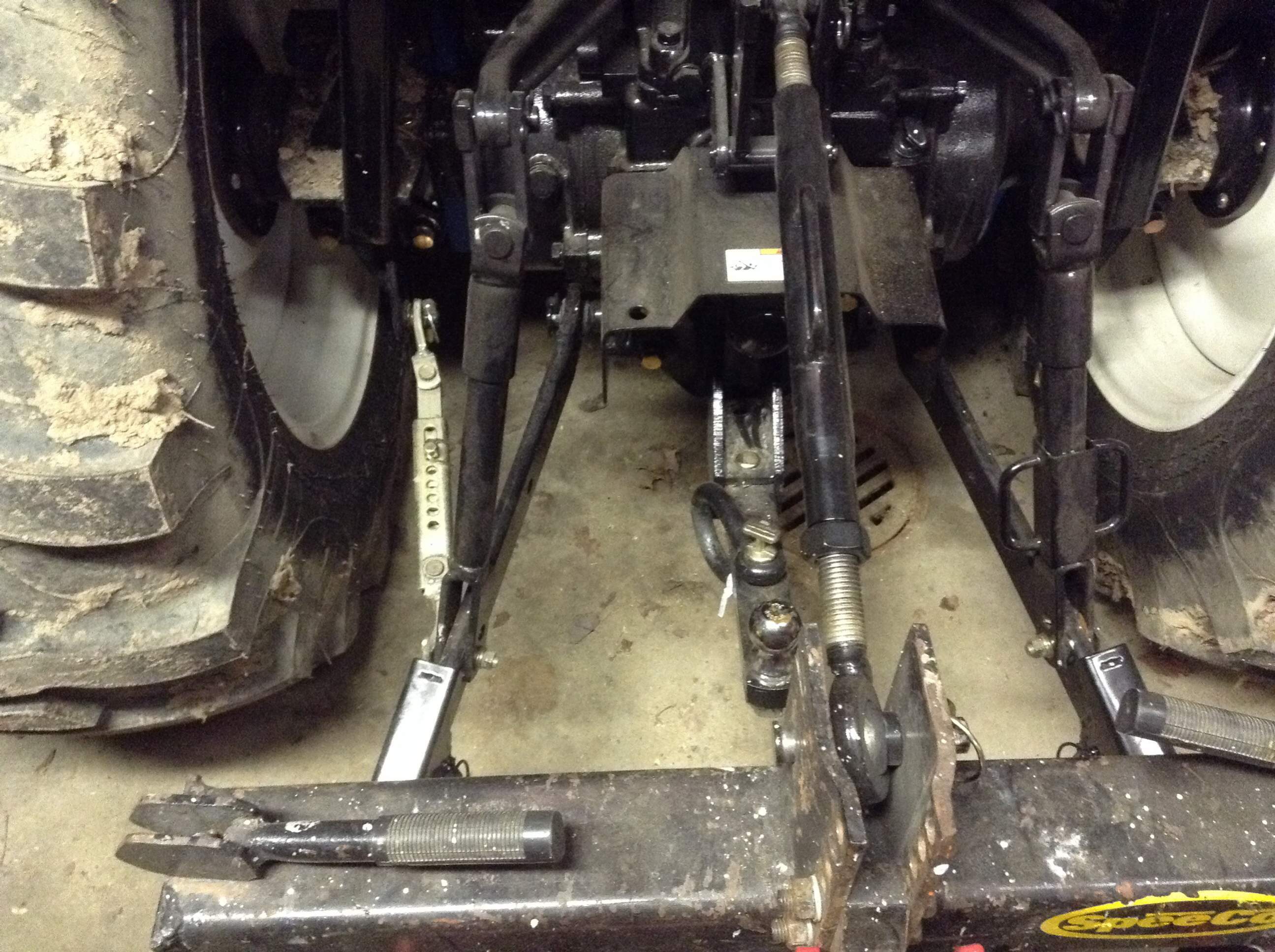

I have a quick-hitch on mine and I adjusted the stableizers as tight as I could and mine stays put and I have no slop in mine, and I carry my 1800# ballast box most of the time. Mine don't even come close to the tires with Cat 1 implements.

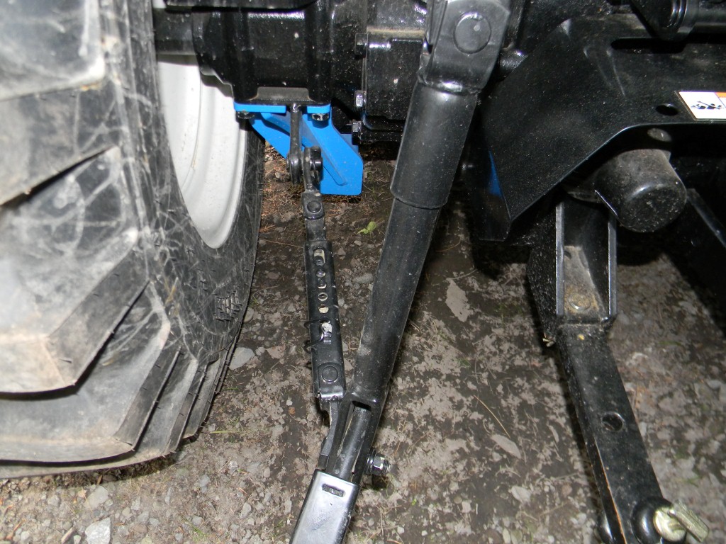

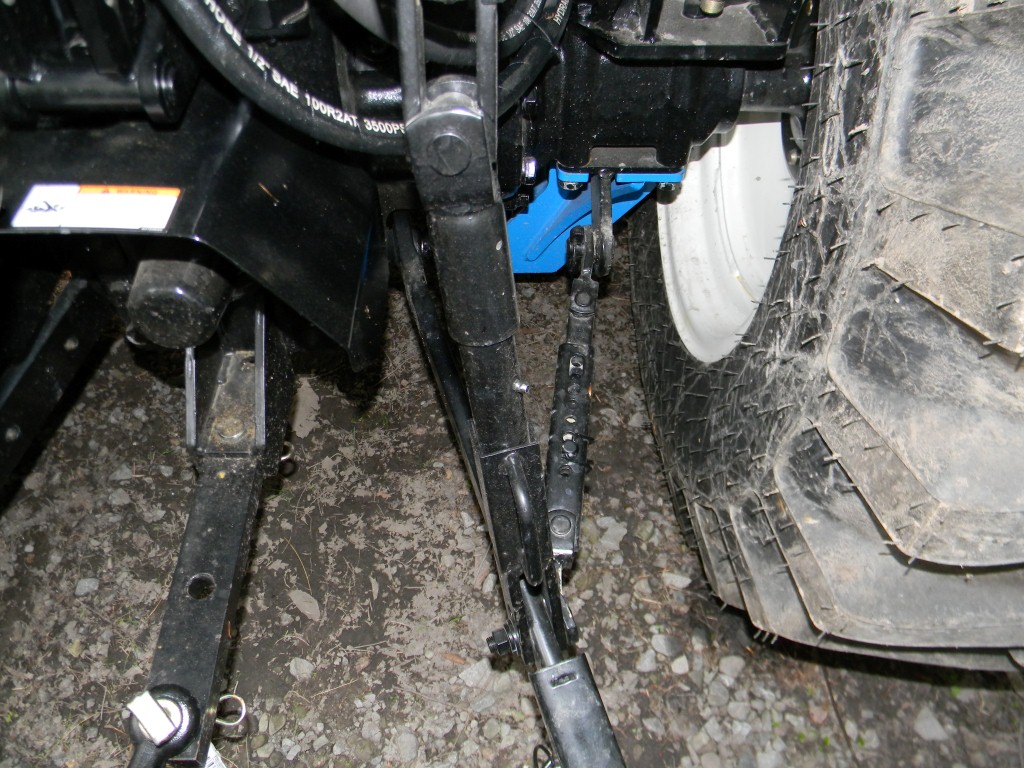

I have the XR series. The 3 pt. stabilizers look identical to Underdog's. I also have a quick hitch and have maybe 1" movement side to side.
