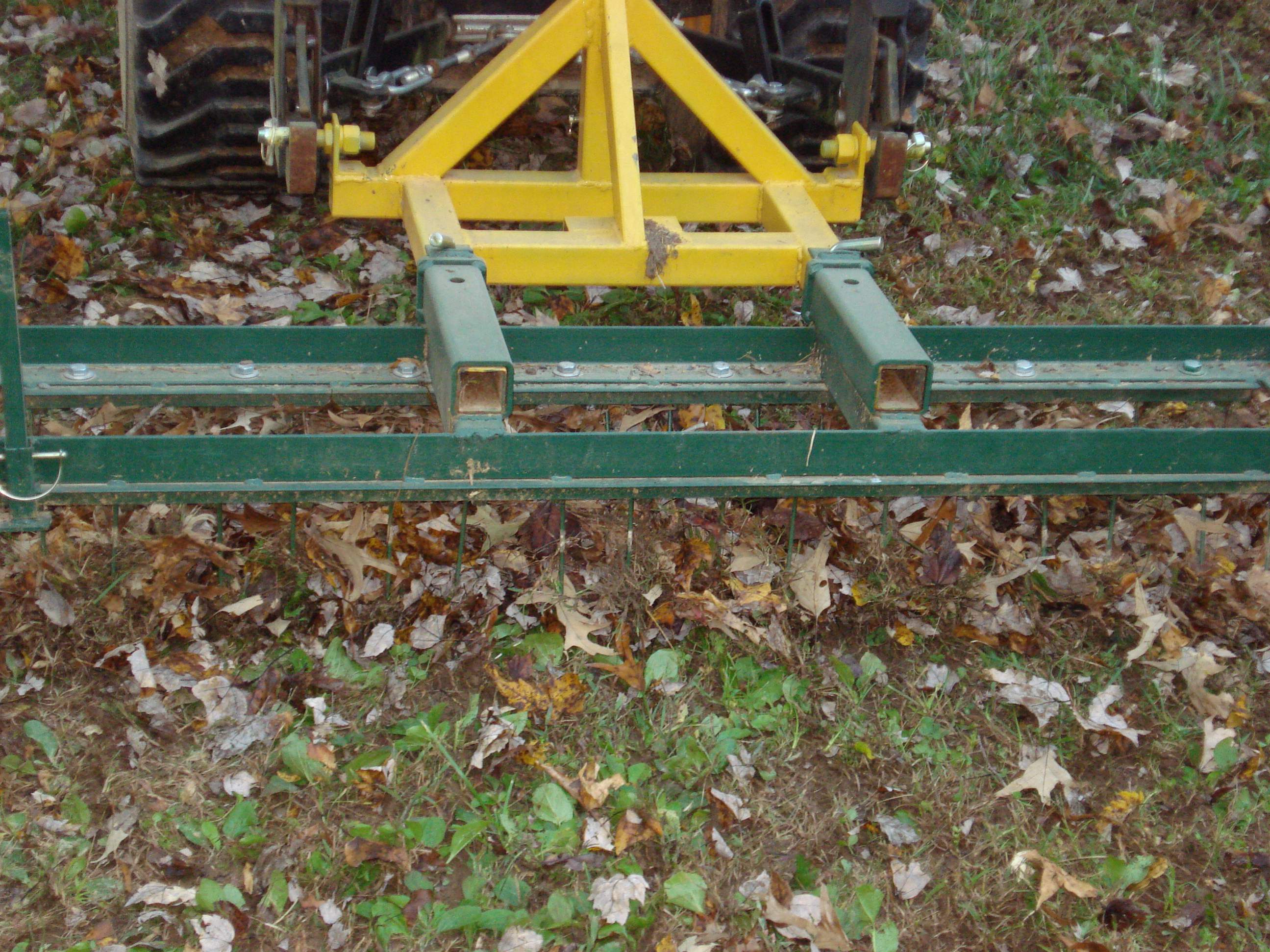

Nice! I've been thinking about building one of these for awhile. I would be really curious to hear how it does raking leaves.
I would assume it would work great. Here's some pictures of the one I built. It's the only thing I use to rake up leaves in my father in-laws yard and mine.
I built the 3pt part to be used on other things I've built like a basket and a sprayer. It comes in handy as I can just build attachments to fit the 3pt piece instead of having to build the 3pt part on the attachment.
View attachment 334651View attachment 334652View attachment 334653
Neat set up.....
In my version 2, I'm going to spread the rows of teeth further apart so they self clean when the implement raised.....
Good luck...
