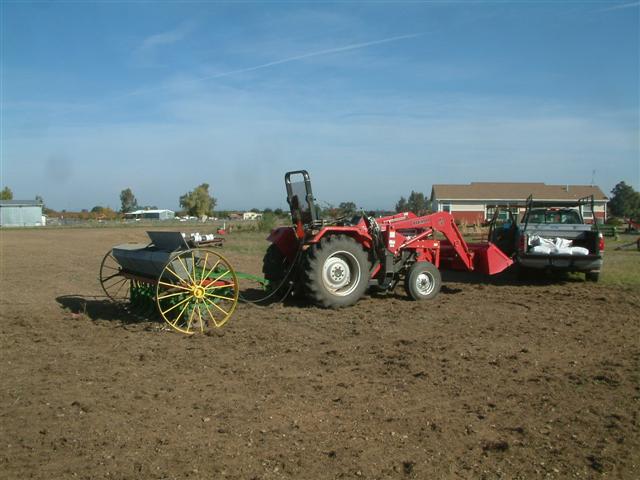

We used the tractor and tiller in my sig line for about an acre of grassland prep to try growning a boutique grass. While the bedding was PERFECT on the first pass, there was some significant lack of mental focus on the seeding and we did not get the expected results.
It really did not take long and based on what locals tell me, if we had used a plow/disc setup it would have required a minimum of two passes and most likely three. A larger tractor could have done it in 1 or 2 however, we just cannot get enough traction with ours for "real" ground engaging field work. It is not an issue of HP, but one of weight.
