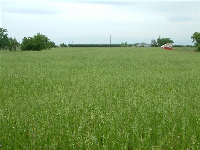

I see a lot of post/advertisements for 3pt tillers, but i was under the impression that they were primarily for light duty garden use. I am not familiar with tillers so please bear with me for a few questions.
We plant approx. 15 acres of corn and oats and i am curious if the new tillers would cut down on fuel and time required to prepare the fields. Currently we plow, disc, and then drag the fields which ends up requiring going over the fields 3 to 6 times. If the new tillers are capable of this much use i would think that even if you have to go slower, one time through the field would still end up being faster and cheaper.
Are the new tillers capable of being used for larger tracts of ground?
Has anyone used a tiller for this much acerage? If so how was the experience?
How well do the tillers hold up?
Obviously fields will have more rocks than a garden, so how do the tillers
handle rocks?
Any info and recommendations will be appreciated.
Dave

Tillers can be used for large areas of ground. It just takes time.
I have tilled about maybe 10 acres with my C250 and with my JD6715.
It was a slow job but it got the stuff done.
If you buy a good tiller, like Maschio you wont have many problems.
Just make sure your PTO shaft doesn't break from the slipping on the clutch. Just tighten that up lots but not seized.
My E180 I had that for about 14 Years, it was used heavily about 8 years ago. But now she justs sits and waits for spring work.
The rocks will just tumble around in the chamber of the tiller if you know what I mean. Large rocks you might want to clear them. They give your blades a good grinding. You can probably get away with small rocks but not big rocks. Your tiller might jump up from the rock a bit. I hit a few pieces of old logs in my ground.
Just didn't find them. I didn't have a problem with them. I used to have a Terranova TC205 which is a re badged Maschio C205 (same company just different names). That lasted me a good 8 years till she got sold also I burnt the clutch on the PTO shaft. Wasn't a expensive fix but it costed a few dollars out of the wallet and got my self the C250 on my 6715.
