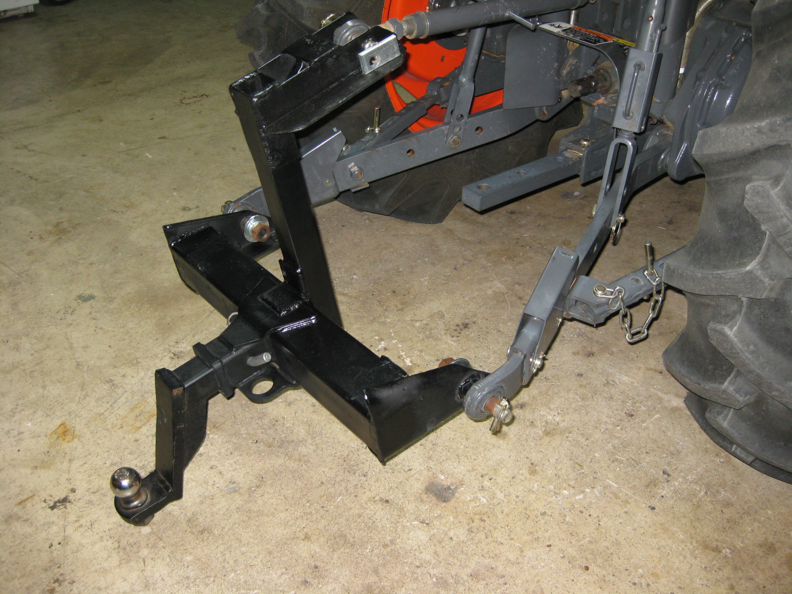

This is what I made from a old truck hitch. I cut to narrow the hitch to about 25 inches wide.. Then simply flipped the wings that usually bolt to the frame of the truck downward and welded back together...Simple and strong...
