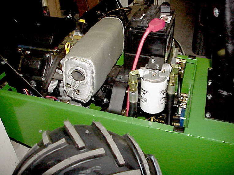

This is from the RIGHT side of the machine. Note that the hydraulic oil filter is VERY accessible.
The current 8" or so longer length has been well used for ease of maintenance and repair.
SIDE NOTE--Is this muffler USDA approved as far as being a spark arrestor? The last person careless with fire in our part of the country burned 100,000 acres. Yes, that is One Hundred Thousand acres.

</font><font color="blue" class="small">( SIDE NOTE--Is this muffler USDA approved as far as being a spark arrestor? )</font>
I doubt it. I vaguely recall getting some sort of certificate with an engine that met the spark arrestor requirement.

Looks just like mine, yours is a lot cleaner. Now its time to start having fun and get it a little dirty.

So, your hydraulic filter is in the same location as mine, only a foot higher. Mine is down in the engine compartment in the front right corner. Yours will be much easier to change. /forums/images/graemlins/grin.gif
As others have mentioned, they keep changing designs and tweaking it to improve the product. I like that. /forums/images/graemlins/smile.gif
