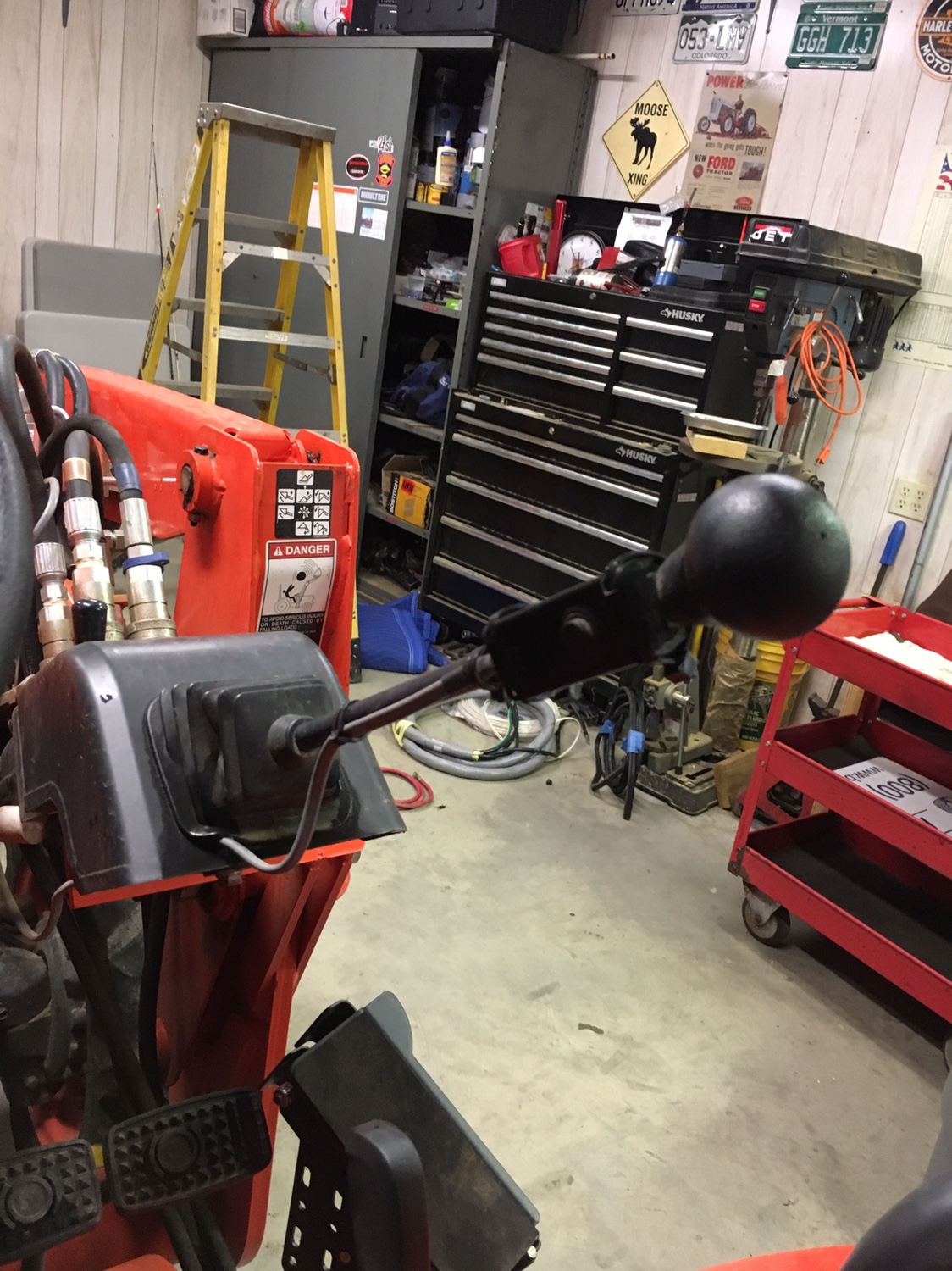

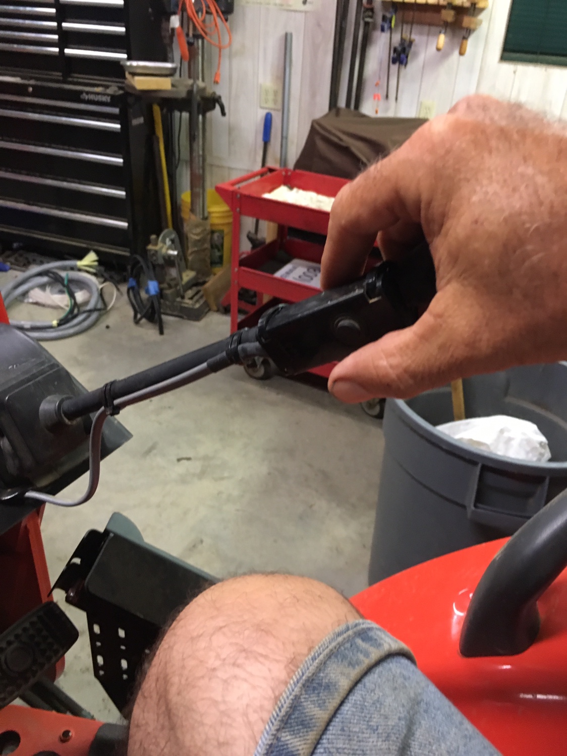

Here's another route if someone has not purchased the joystick with button. IMG_1946.JPGIMG_1945.JPG
I bought the diverter valve kit from Kenny D rather than third function. It came with this switch I have almost 2 years on it with my grapple and it's worked flawlessly.
Button sets right under the ball of my thumb for a natural press on and off for the grapple/curl functions.
Lenny
PS. Quit looking at my mess! I'm cleaning it up already!
