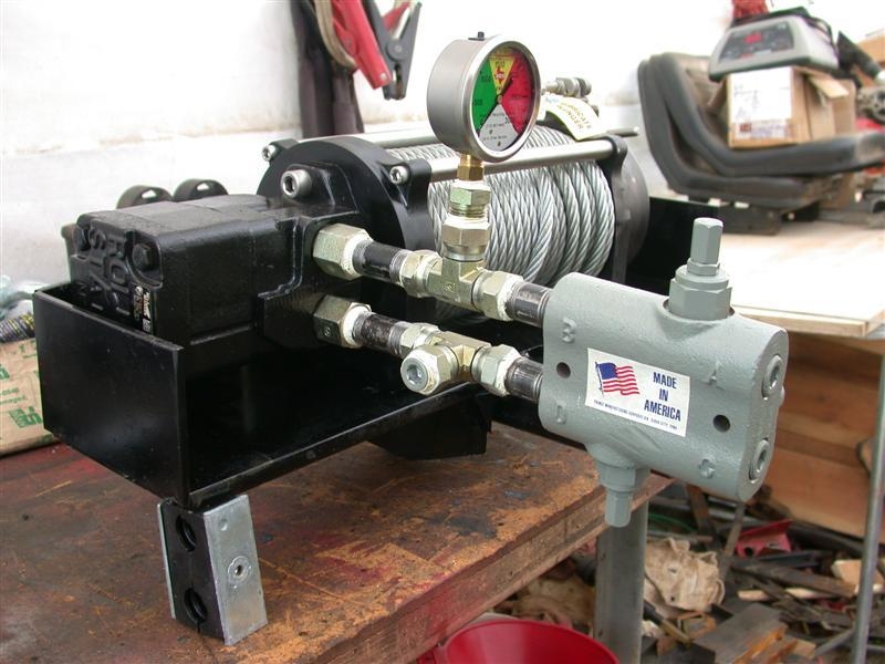

   / 3rd Function for L45 #29
#30
You can not use a motor spool with cyl. All ports are open to tank and a cyl needs a spool that will lock the fluid in the cyl.
Here is the kind of relief valve you need across a hyd motor.
This one is on a hyd winch.
This diagram shows how a 3ed function valve is connected in the path of hyd flow.
http://www.tractorbynet.com/forums/...ydraulic-motors-front-hyd-do3b-flow-diagram-1
