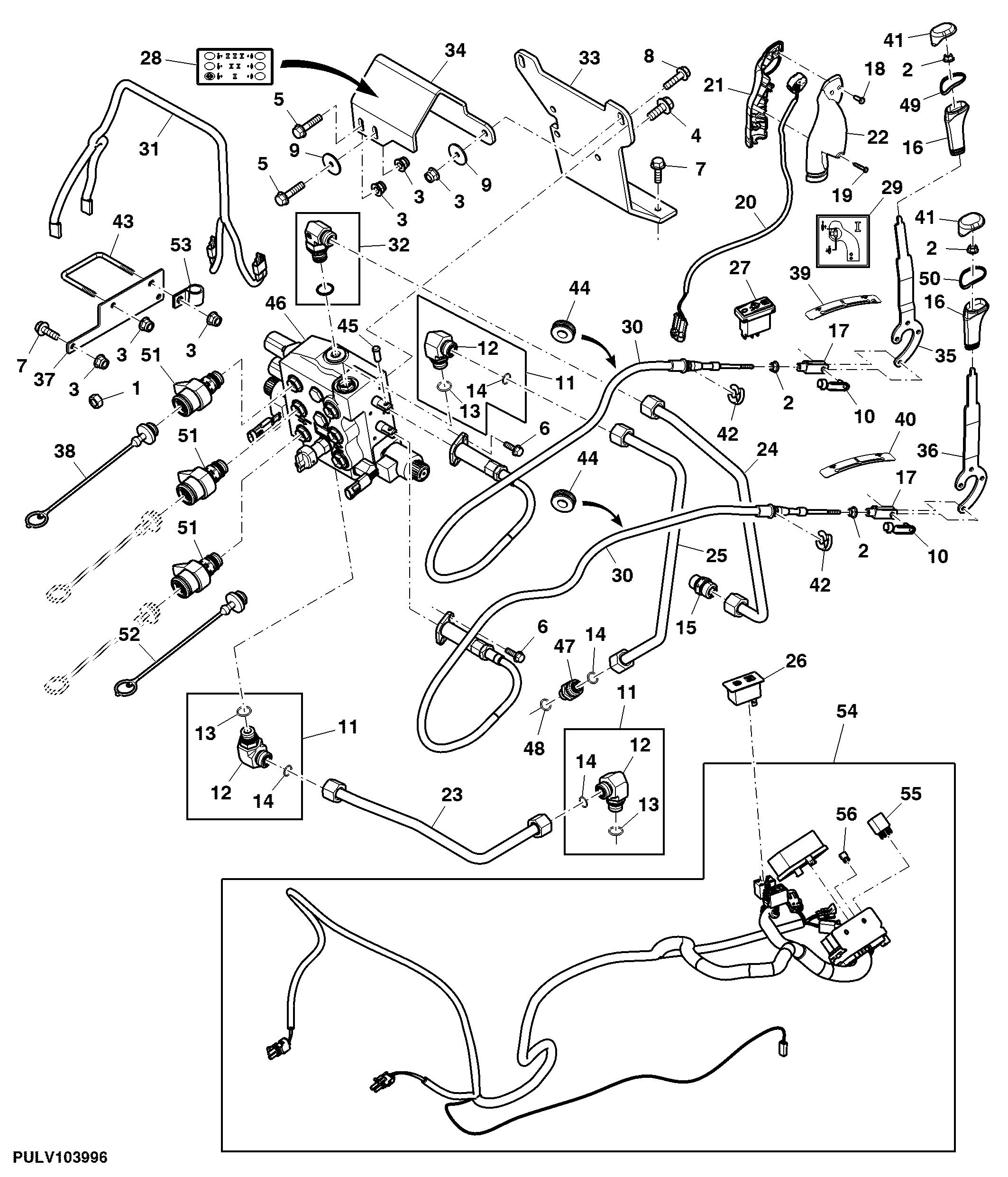

Hello all,
I am planning on adding a grapple from everythingattachments.com to my JD2305. I know that this is a complex process what with getting the power beyond up and running. I basically have two questions:
Is there a cheaper route than either Deere or everything attachments (both in the 750-800 dollar range) to run power beyond (don't have it yet) to the loader.
Secondly, I am kinda choosy about the grapple control. I really like the style of grip found on most deere 3000 and 4000 series. I know that I have a vastly smaller tractor, but does anyone know if the actual "pistol" grip with remote thumb option is available and if it could simply be stuck on top of my existing loader joystick rod? I don't mind wires running down the side of the stick--I can easily control that, but the position of the hand on the control seems ideal on the JD series.
I did go to the dealer, unfortunately I did not speak with someone sufficiently knowledgeable to answer this simple question
Thanks in advance!

Do you have a rear remote? Just run the lines up to the grapple from that, you wont have the fancy pistol grip with thumb control on your joystick, youll use the remote lever, but you will have about $700 in your pocket:thumbsup:

I do have a rear control for the 3pt hitch, and I know that I could use that. However, if I am correct here, it means 2 aspects I don't like:
1 I would lose the 3pt hitch functionality till I plumbed it back (more easily solved with a diverter valve)
2 I would really like to maintain control of all the grapple controls in 1 hand
/ 3rd function grip handle #6
I didn't mean the three point control, I have two extra sets of hydraulic ports (4 lines) off the back of my tractor along with the 3 point. Thats where I ran my grapple from. True you do not have control of the grapple from the joystick, but it dont cost $800 either just a couple extra feet of hose. Didn't seem to be that hard to get used too, especially considering it would have cost me alot more for the control than it did to build the grapple. Good Luck :)
/ 3rd function grip handle #7
On my 4300 i have the joystick which controls two valves, plus I have the 3rd added valve control on the right fender. The actual valves are all side by side down under the seat somewhere...at the bottom of the joystick. The lever in the fender is connected to a cable that controls the 3rd valve. This valve controld two qd ports at the rear of the tractor. These could also be plumbed into lines on the FEL for a grapple or snowplow angle control.
/ 3rd function grip handle #8
I don't know if you can get an electrically controlled valve for your tractor. You can buy the 4000 series grip with the switch for about $76 from parts. Numbers 18,19, 20 21 &22 in the drawing.

You can get a kit from TSC and orschelins that includes a solinoid control valve and switch for the loader joystick for around 400 bucks. You can also purchase itms separately from any hydraulic supply or large farm coop. That is if you already have power beyond. Which my 4200 John Deere has. This is what I plan to do if I ever get around to getting me a root grapple! If it were me I had rathe have it on the the joystick instead of monkeying around with a another lever so I don't have to take my hand off the joystick! I have operating both kinds. LUTT
