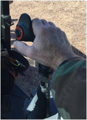

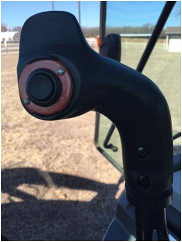

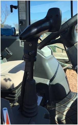

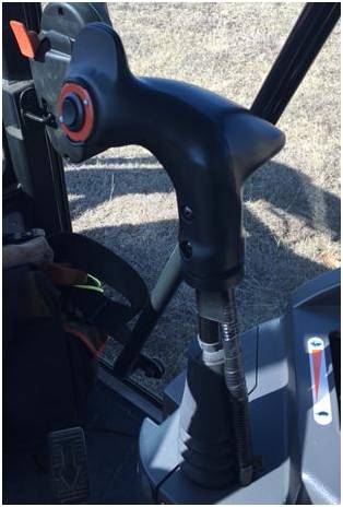

Deanocraft, here are pics of the John Deere Grip installed on a Kioti NX5010

Kit looks good, you might save a few dollars by sourcing everything on your own, but it’s really not worth it if your not sure what all you need anyway, plus having to build the brackets and such. As for mounting the handle, I used one similar on my kubota, I removed the knob and had to bend the a inch or two of the lever so the new handle was straight up and down, was very comfortable position.
