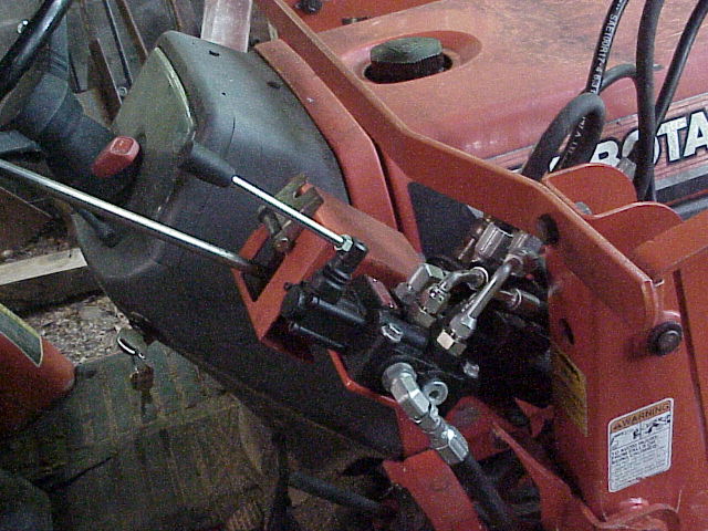

Got nothing against diverters they are very popular...But...
...IF...the loader valve has a PB port...IMO, adding a dedicated grapple/thumb valve is really easy...and probably the least expensive way to go...
The hardest part is deciding where and how to mount the valve...
Having an independent valve also allows some detent options...
Below is a pic of how I mounted my front remote valve...I made a longer, more ergonomic control lever...
...for the particular valve I used (less than $100) I have a hold detent that takes the place of a "bungee cord" etc. for remote use on log splitters etc...
FWIW...I use the detent mostly on a skid mounted hydraulic winch that can be chained to anything...have a set of 20' remote hoses...
BTW...When I was acquiring the grapple parts I found a set of OEM K_ubota FEL hoses (5) for unreal cheap...I only had to buy the short PB hose...sorry for the grainy pic...and good luck with whatever way you go...a grapple/thumb on an FEL is like T&T for a 3ph...

I like that! Are those levers positioned so you can articulate them with one hand? I run a 4n1 bucket and you need to float the arms, curl the bucket and close the bucket all at the same time to pickup the last bit of lose dirt on the ground. Looks like that set up will do it.

I went the other way and cut my handle shorter. Yes I can control the grapple and FEL at the same time. The other 2 are hydraulic toplink and tilt (sidelink).
OK, I better figure out if the loader valve has PB. If it does, then I like that option, easy for me to understand and use. The housing around the loader valve is just sheet metal, but maybe it's heavy enough that I could mount the thumb valve to it like you did. Thanks.
Another option should the loader valve not have a BP port is to get a valve for the grapple/thumb that does have a PB port and just plumb it before the loader valve...i.e., use the PB port on the new valve to supply the loader valve...
/ 3rd function - help me decide #14
The loader is a SMC Model 84Q aftermarket job. In the manual the valve is called a "Dukes DV-27 valve" and it does show a "Power Beyond Kit" in the parts list.
Sounds good...you will just need the internal carry over plug that gets installed (inside) once you remove the PB cap...
...One other thing you will need to discover is what type/size the loader valve's ports are...generally they are SAE (ORB)...but not always...
You can "T" the return lines together anywhere that is convenient...I put a "T" directly on the tank port of the FEL valve...
