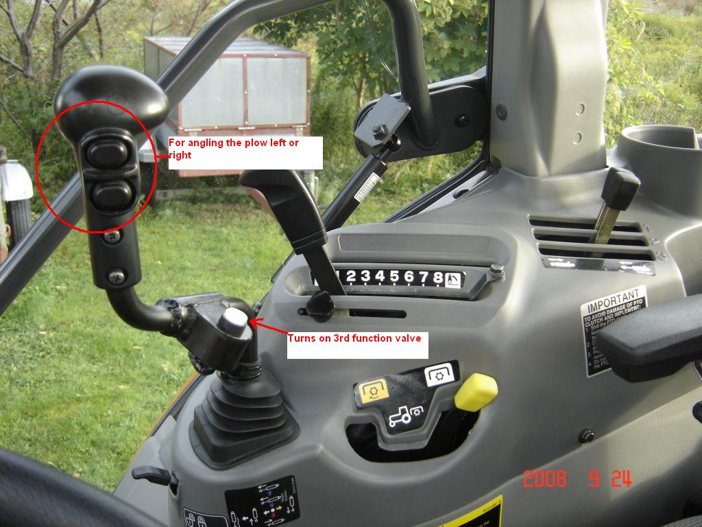

I've had a few guys email and ask me what the other buttons were on my joystick so I figure the bast thing to do is post it in a separate thread and that way if anyone else wants to see it they can.

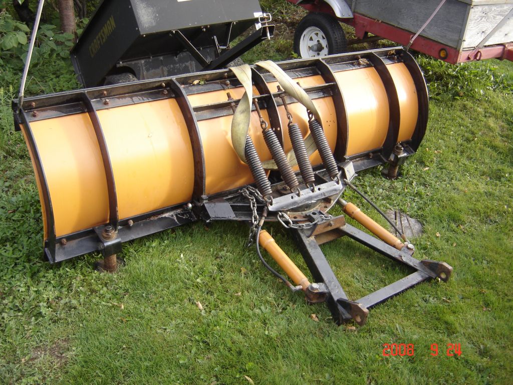

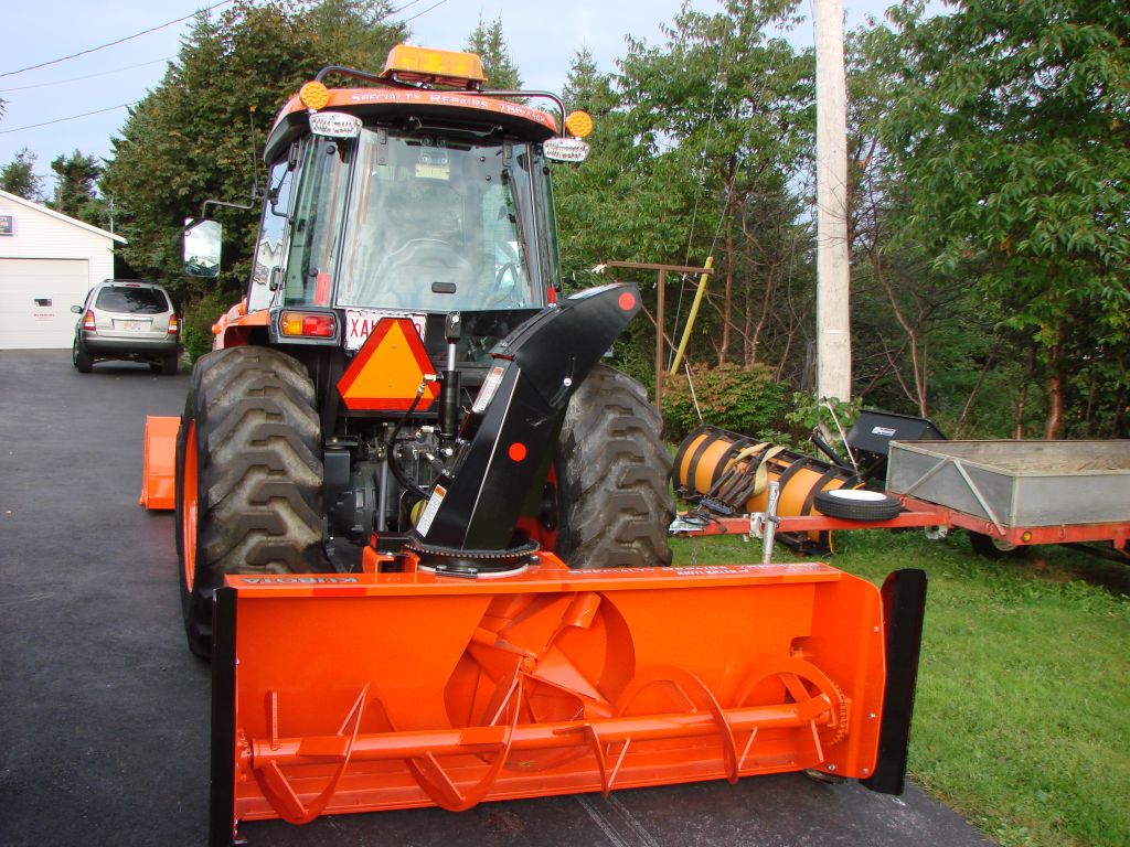

I'm getting my new tractor ready for the coming winter. It has a quick change system on the FEL and it came with the bucket. I've always plowed with a angle blade in the past and I know it's a much faster way of plowing snow.
to use my Artic blade on the tractor I had no way of angling it when it's on the tractor so I had a 3rd function vale installed. there are two extra hyd ports on the front of the FEL now so the blade hyd lines will connect.

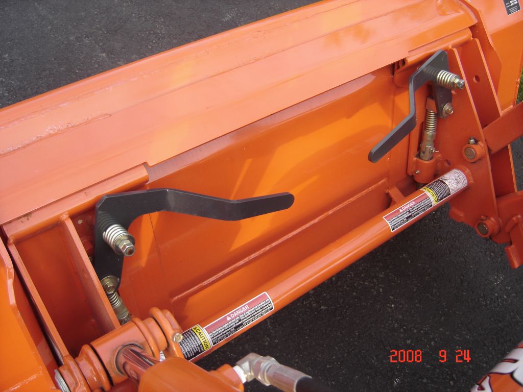

I was in the process of building a quick change adapter for the FEL and realized I could purchase one cheaper than I could maker one so I have that on order now and it should be here in a week or two and I'll just adapt my blade to it them.

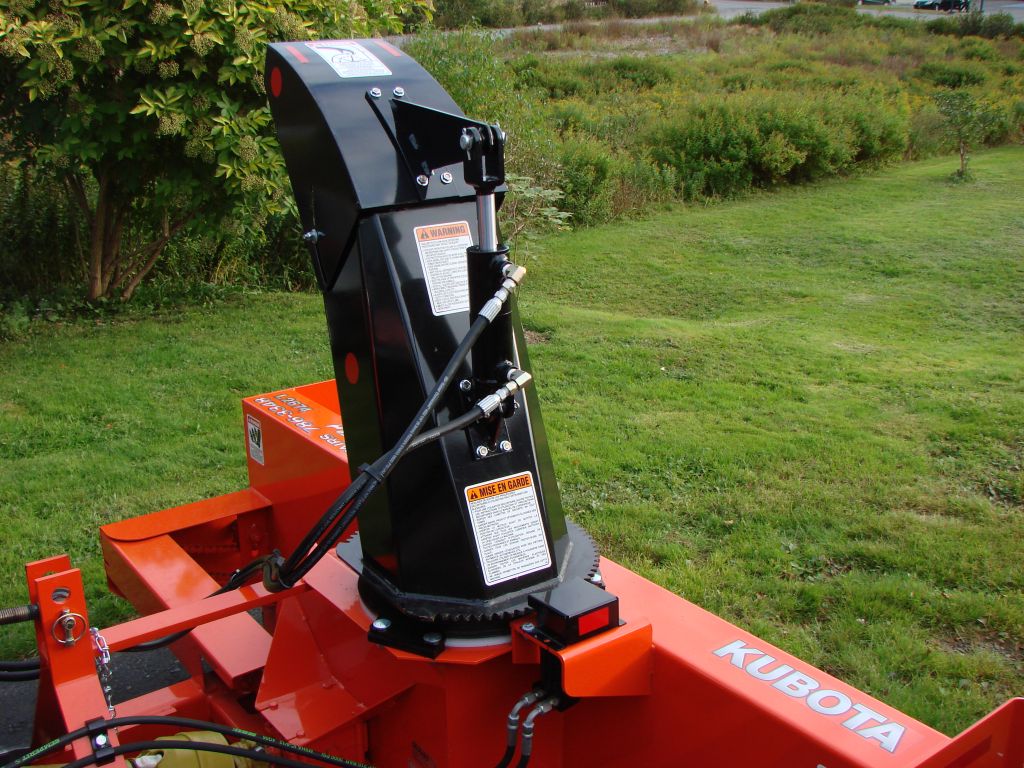

I also got my hydraulics completed for the blower. I just need to do a little tidying up on two lines. I like this set up. No cables or leavers. Hope this info helps.

My dealership didn't connect the on/off button. Said he's had issues with them in the pass so my actuating buttons are always on. I don't know why'd you'd want to turn them off and on anyway?

I don't know why it's needed. It could be because it's a safety feature or there might be a duty cycle on the solenoid. Not sure but I believe that if it's supposed to be there, leave it there.

Hi, I just bought a new M108X and I had the third function valve installed to use with my plow so it will angle, the togle swithch that turn the valve off is for the fourth function, which is usually used to open and close the quick connect on the bucket, the off switch is so the bucket lower pins are not opened by accident while using the joystick.
I do have a problem that you may be able to help me with, my third function valve which angles my plow or when not activated will allow me to tilt the plow foreward so I can back drag better, my problem is that this valve does not always work, sometimes it works well for a long time then suddenly instead of angling the plow it tilts either forward or back ward, it seems like the solenoid gets stuck in one position and does not move even when I am holding the button down on the joystick, I have checked all the wiring and have power at all locations, I removed the solenoid and placed a screwdriver in the hole and it is held by the magnetic force, yet for some reason it does not activate the hydraulic part of the valve, it seems the freeze, the temp was -20 C, but these valves should work way below that temperature, I don't like to take the valve apart since it is on warranty, but my dealer is 50 miles away, if someone can think of a simple fix I would really appreciate it.

Hi Jim. Congrats on your new tractor and a fine tractor it is. If your set up is like mine with the main switch on the operators FEL control lever I would suspect a switch problem. I've heard these switches have been known to cause problems in the past.
When the 3rd function switch is either on or off on my tractor I can still use the "tilt" for my blade. The only thing the 3rd function system does for me is allow me to angle my plow. All other functions are the same along with that 3rd function valve set up. In the mean time if you suspect a solenoid you might try just tapping on the thing when it kicks out. I doubt cold weather got anything to do with the problem unless there's moisture in there somewhere. I removed all the outside wiring connections on mine and used die electric grease to keep any water out of the connections to prevent that from happening to mine.
