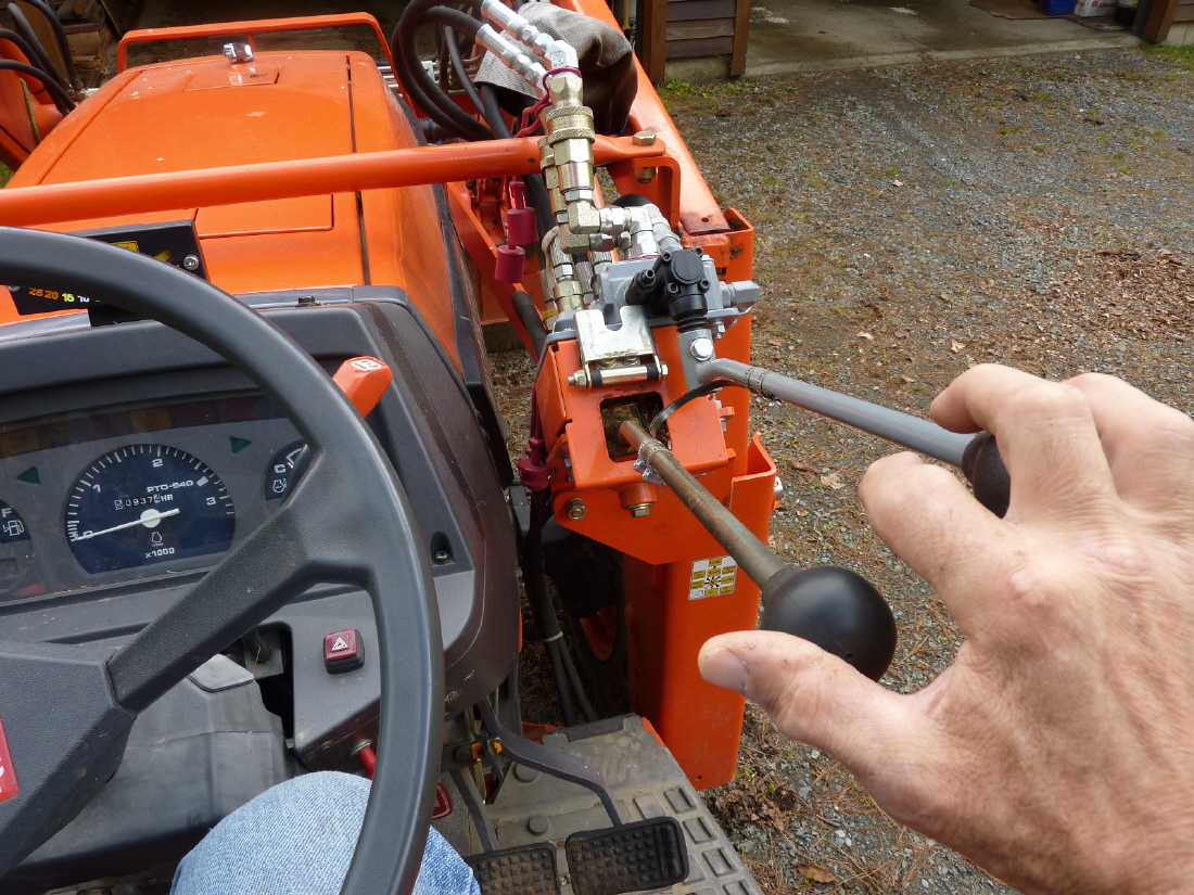

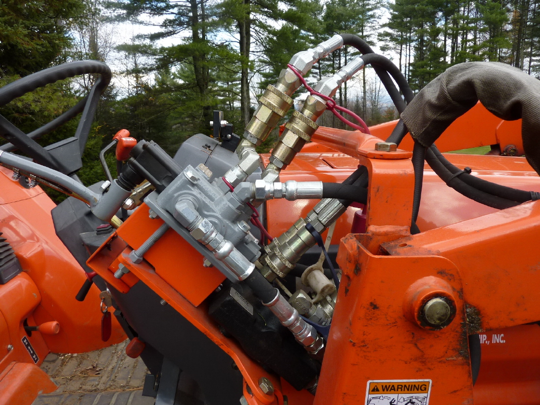

I put in a separate single spool valve. For me the cheapest way to go. About $275. Full feathering control (which I use all the time). Run both valves with one hand.
Parts Shipping
Single Spool Valve Surplus Center $89.95 $12.98
5 1/2" X 6" X 1/4" Plate Walbridge Welding $5.00
Includes weld nuts
18" length 1/2" rod Walbridge Welding $6.00
Includes welding bushing
Knob for lever arm Messicks $15.37 $13.61
Fittings Discount Hydraulic Hose $55.77 $16.09
3 short 3/8" hoses w/ jic 8F $60.00 --------- ---------
$232.09 $42.68
