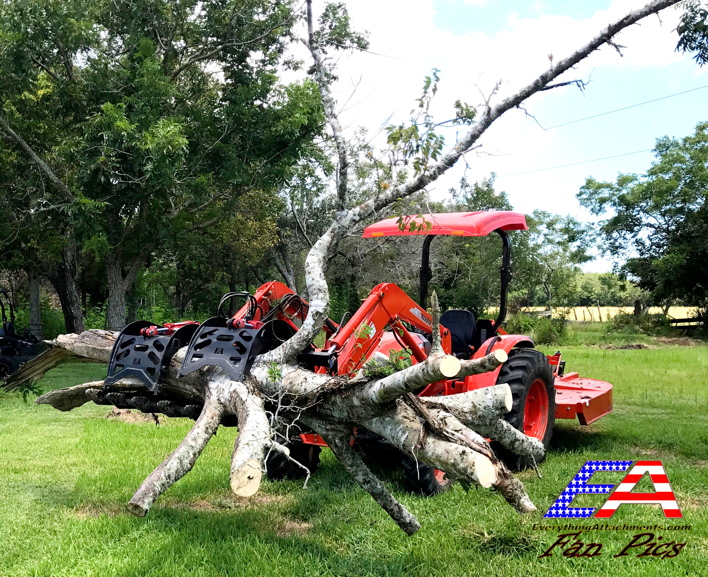

My tractor knowledge is limited so bear with me. I'll be picking up a NX4510H next month and most likely will buy a grapple for it in 2019. Visited the dealer yesterday and they told me this would require the 3rd function kit at a cost of roughly $1,000.
Fair price? Are there difference brands to consider? Should I spring for this now and wait till next year? My gut tells me to have it added now and be done with it but would like some more experienced opinions.

Kioti, Mahindra and many other dealers have been using this custom 3rd function kit by WR Long for years.
It is a complete kit with instructions and it is available for a HUGE variety of tractor makes and models.
With almost TWO HUNDRED customer reviews, you can buy with confidence.
We offer the custom kit for $837 and we're currently offering a $50 off coupon code if you order with a Wicked Grapple! Free ground shipping to your home within 1,000 miles of Newton, NC.

Just be sure of what you're getting for $1000. Are they furnishing a true 3rd function kit like the WR Long or are they installing a diverter valve on the bucket curl function? I found the diverter valves are less expensive. The difference is a diverter valve uses one button you press and hold to activate it while using the bucket curl function to move the hydraulics. A 3rd function has a rocker switch you press and that's it, no loader valve motion required. The 3rd function gives you flow as on or off only whereas a diverter valve can be "feathered" just like curling the bucket. A lot comes down to personal preference which one to pick. 3rd functions dealer installed in my area are in the $1600 range and diverter valves are about $1000.
