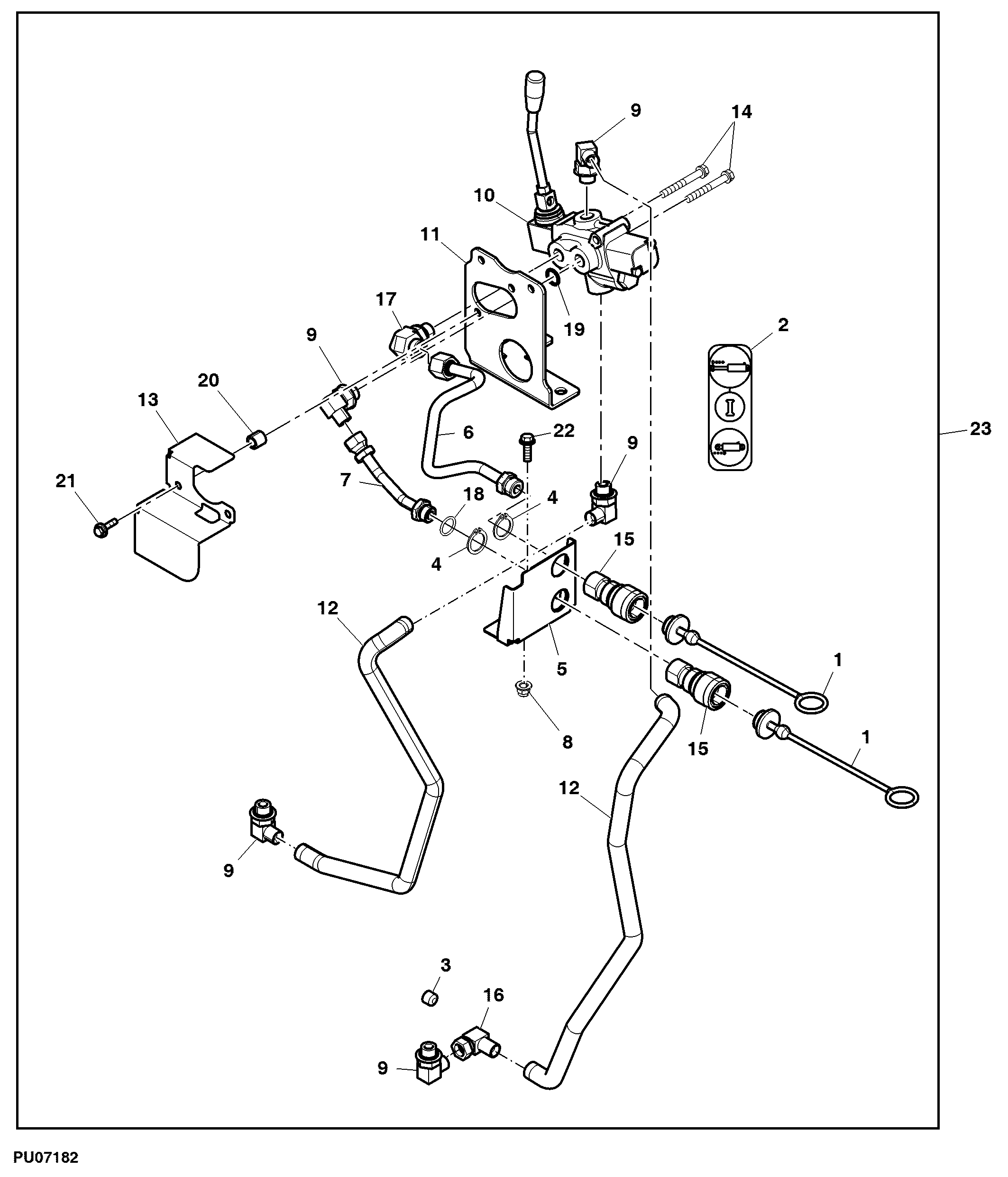

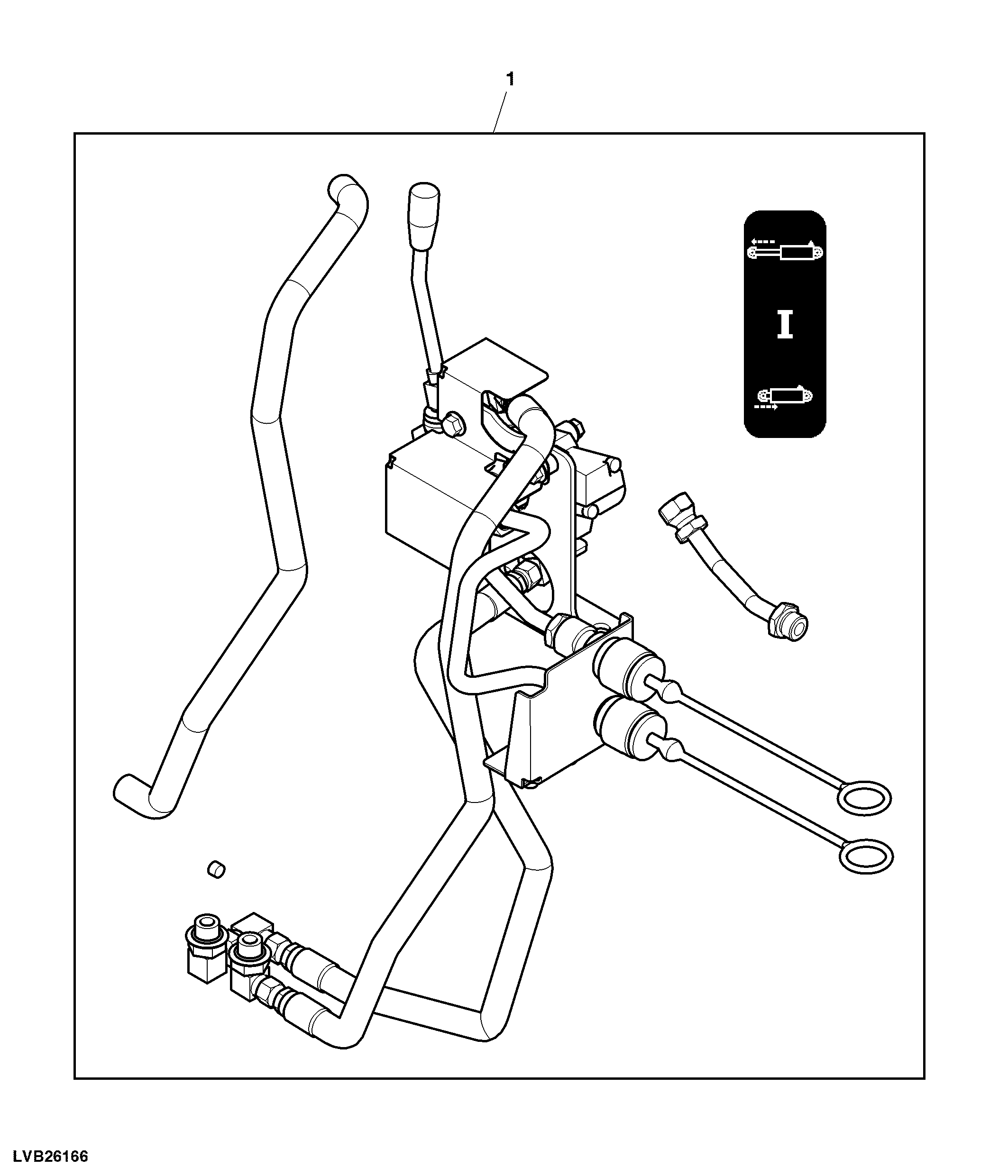

I was thinking of doing this to my 2320 also and found this kit LVB26166. To me it appears to connect underneath the loader control valve, I checked on mine and its has two allen head set srews plugging two holes with I'm thinking is where it hooks up. I posted some pics of the set-up and beak down.
   / 3rd SCV for 2320 #13
Yes those two plugs on the SCV are for the power beyond kit also, so this new SCV will will only work if you never intend to have that or a backhoe. You will also have the remove the SCV to install the internal plug, #3 in the second diagram, it forces the fluid to go to the OUT port and through the new valve (or PB kit, it's the same plug used there also).
Brian at FitRite hydraulics may have a kit that offers more spools for a similar price, a lot has changed since 2010 when this thread was started.
   / 3rd SCV for 2320 #14
Thanks kennyd, is this something that I can install myself? I have basically no hydraulic experience.
   / 3rd SCV for 2320 #15
Take a look here. I have done these with as many as 5 valves so far. If you are mechanically inclined at all, this should not be a problem for you. Seems like 3 sets of remotes is the most common though. ;)
   / 3rd SCV for 2320 #16
Yes, this is a good DIY job. Don't get intimidated just because it's hydraulics, it's still just wrench turnin'
   / 3rd SCV for 2320 #17
I'd like to do it myself. Meaning buy a valve and run all the hoses and connection myself rather then bying the JD kit. Reason for this is because I would like at least two SCV at the rear of the tractor.
   / 3rd SCV for 2320 #18
Does anyone here have a 2320 with a 3rd SCV installed? If so can you post some pics of exactly where the hoses need to connect to the loader valve. It would be greatly appreciated.
