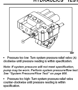

I might have missed the answer due to all the "fog" above, but can anyone say where the relief valve to adjust system pressure is located on the 3X20 CUT series tractors? A photo would be even more helpful. Thanks.
   / 3x20 300CX hydraulic operating pressure #16
It's on the SCV.
jimgerken,
you remove the black cover that goes around the seat, 3 point adjustment knob, & kind of cleans up all of the lever openings, I believe there are a total of 10 or 11 fasteners (10mm), some in front of the seat down at the floor level, one on each side just in front of where the ROP's uprights are and 4 behind the seat (unless you have the 3rd SCV, then you may have to remove the bracket; 2 additional bolts) for the outlet support arm. The drop adjustment knob will pull right off with no problem, just pull forward with steady pressure (it's kind of like an old radio knob only much larger). Once you get the shroud loose, lift up on the rear & move it forward a little, you only need about 1" of forward movement. Look at the attachment that Cocre has in his post, the part that is referenced as (A) is the relief valve adjustment you are looking for, it is to the right side of the 3 point adjustment knob (left side of knob if your back is to the steering wheel). There is an adjusment bolt and a jamb nut, loosen the jamb nut & screw the adjusting bolt in until you meet the pressure you are looking for; make sure you have a good Hydraulic pressure guage to monitor the results of your adjustments & don't go too far at one time, little adjustment then check pressure, you will probably find that you will require less than 1 turn to get where you want to be. This is for an open station machine, I don't know what the method is for the cabbed models, but I'm sure it is about the same (sounds like it may even be easier). Remember, modify at your own risk, & never exceed the pressure ratings of the hoses, hydraulic cuts (in human skin) can be deadly. There may be an easier way to do it on an open station, maybe someone can chime in if they know one.
