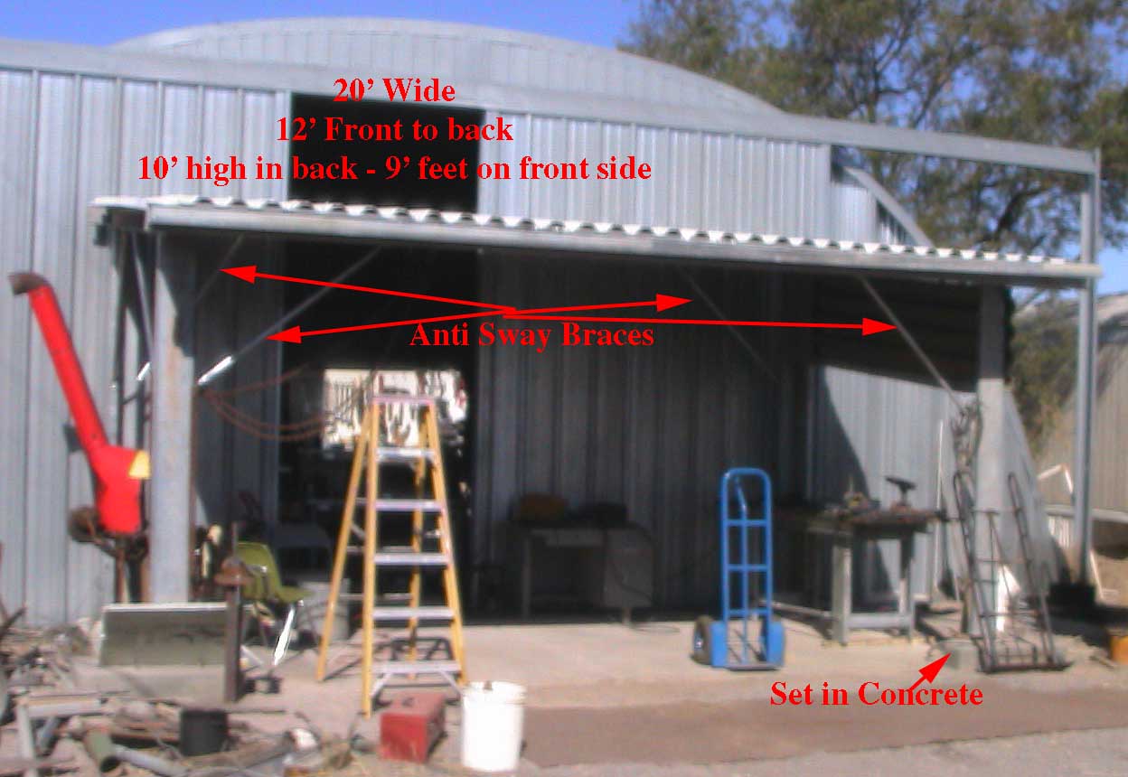

With only 4, 3" corner pipe posts, your asking for trouble. Get some wind and your shed will look like a Hula Dancer.
Look at the picture, that guy spans 20' wide by 12' deep. Corners a 2 "C" channels joined into an "L". The corners are 5/8" red heads 4 on each corner. They go into the exsiting slab. Concrete was poured 18" below the slab and 5" above. Re-bar goes through the corners as well.
At the very least put on sway braces as shown in the picture. Those are 1" pipe 4' long, flattened and double bolted at each end.

More typical to nail a longer wood across the bottom chords, but if you have a pile of 17 inch pieces of 2x I don't see why it wouldn't work, uses more nails. I'd think you wouldn't want them staggered very much, or there will be flex between chords, like an acordian?
As to the old thread part of this, wow, us northern folk sure have to build a lot more than you southern folk can get by with! Four corner posts, 20 foot spans, 1 foot drop on the whole roof - that wouldn't last through most Novembers up here, much less a full winter. ;)
As to the picture of the shed awning; why in the world would someone build a 9 foot high awning in front of a good shed with a (looks like around) 12 foot high door???? What a waste of resources to limit the door to 9 feet.... (As a farmer, equipment keeps getting bigger, shed wall height is always a miserable limiting factor in what you can get inside a shed.)
