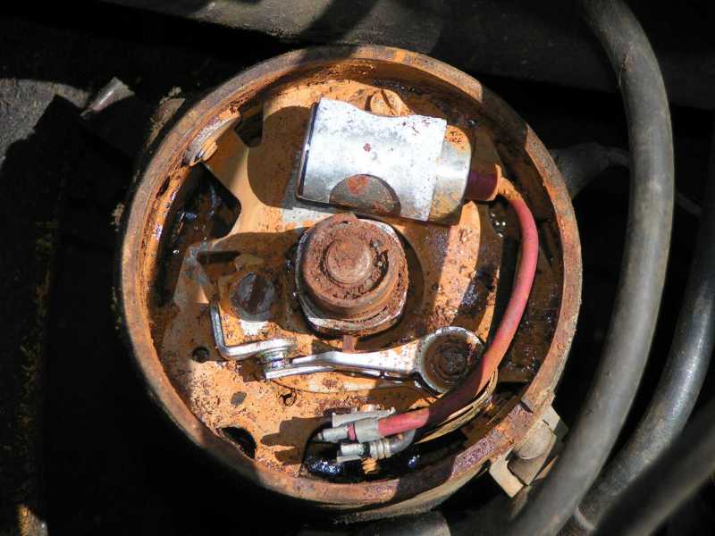

It runs! /forums/images/graemlins/grin.gif
Points and condenser did it. Thanks everyone!!! /forums/images/graemlins/cool.gif

<font color="blue"> Penetrating oil on that advance mechanism may help it free up. </font>
I vacuumed it out and blew it out with air a few times, then oiled it up several times over two days. Cleaned it out as best I could and things seem to move OK in there now.
This has been a great refresher course in how things use to be before electronic ignition.
Also, when I fired it up it started accelerating RPMs and I had no throttle response, so I shut it down. Forgot to hook up the governor. /forums/images/graemlins/blush.gif

Finally got my camera back... just wanted to show everyone what I was dealing with in the distributor with the rust and the points stuck open. After I cleaned it up, changed the points and condenser and put the new needle and seat in the carb, it starts up at idle and runs fine now.
One more thanks to all with the help! /forums/images/graemlins/laugh.gif

MossRoad,
That's terrible. /forums/images/graemlins/blush.gif The inside should look almost like a "clean room" in need of a good sweeping. /forums/images/graemlins/wink.gif I admire your stones for posting such a photo.
