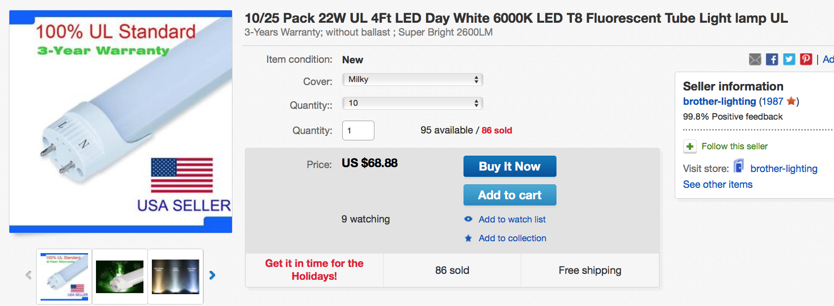

Someone on another forum posted about these 4ft replacement LED "bulbs"
I saved all my old burnt out fluorescent fixtures.
Stripped out the ballasts and rewired them
A hot and ground on one end of the LED bulb
THEY WORK GREAT
Started with a 10 pack and needed to order another 10 pack to finish up.
Did fixtures at my house and my 90 yr old Moms.
Great for sheds and garage in cold temps
1/25 Pack 22W UL 4Ft LED Day White 6K LED T8 Fluorescent Tube Light lamp UL | eBay

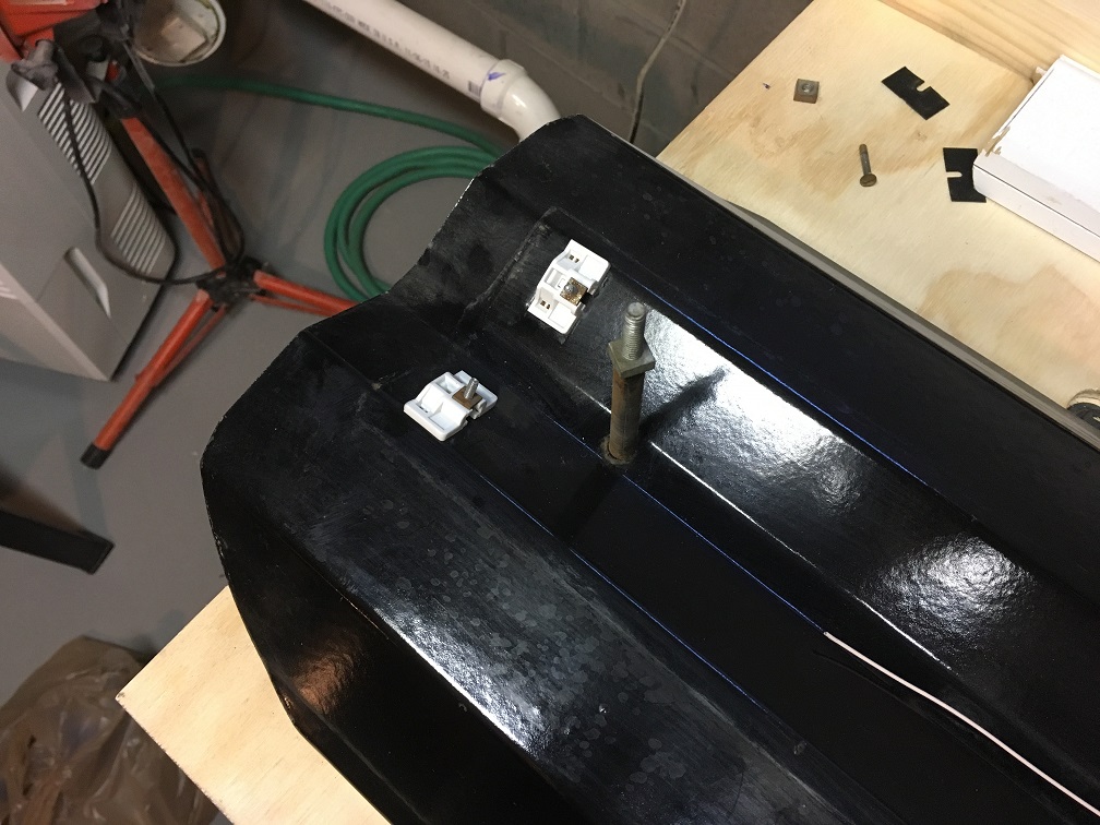

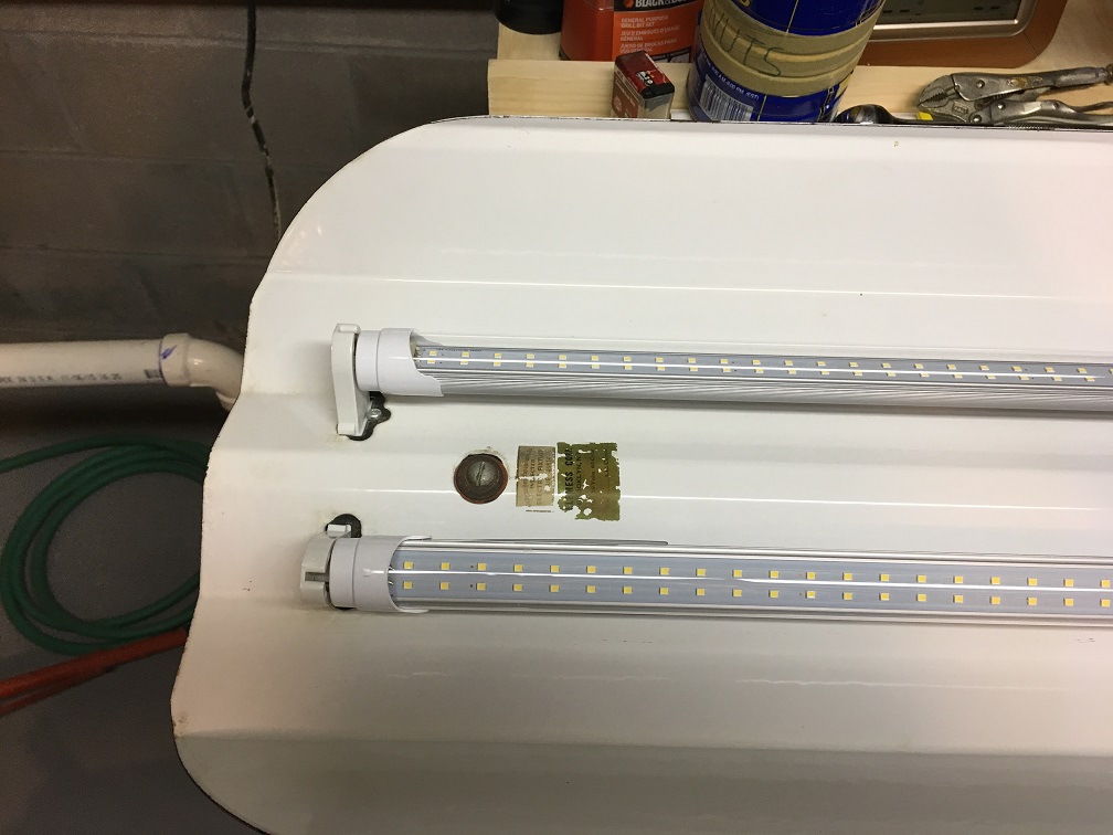

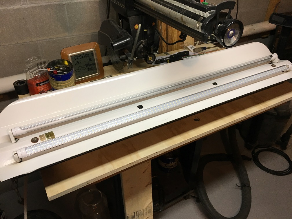

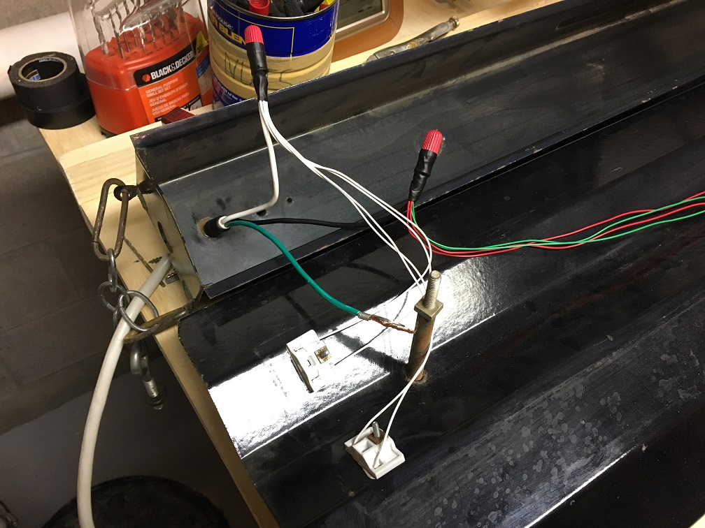

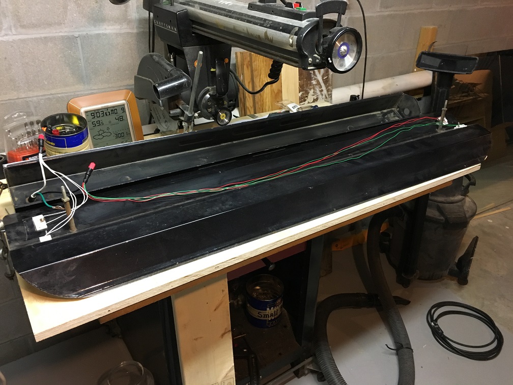

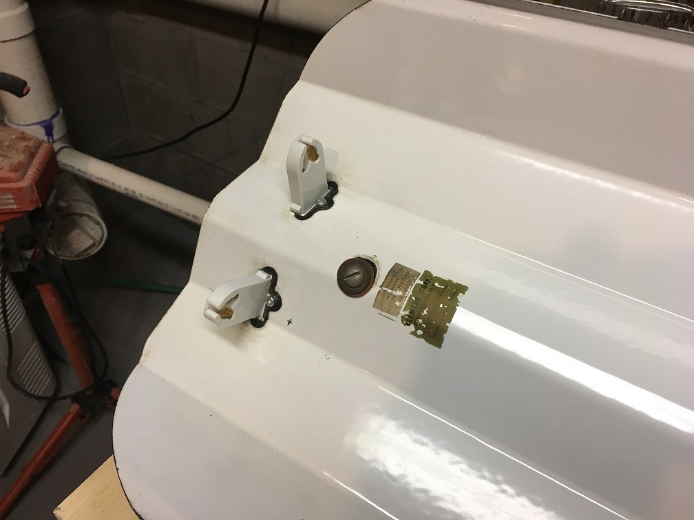

Project Done!
I bought two 4' units from LEDMYPLACE.com. I did look around locally, but stores either didn't carry them or they were the hybrid type that could be used with or without a ballast. I wanted the direct wire type. Anyway, the price was fair and the shipping was free. They are 4' units with two rows of LEDs, 3000 Lumens, 5000K.
I had to wait to receive them to be sure how to rewire the tombstones. They are 'double ended' tubes, so one end of my fixture is hot and the other end is neutral.
Step 1 - Clean up the old fixture. and remove the ballasts, wiring, and tombstones (two of the 4 were broken).
Step 2 - Install the new tombstones and wire them. Got them at Home Depot for about $4.50 per pair. These are non-shunted units and I could have shunted them and probably just used a jumper to connect at each end, but I decided to run a wire to each pin contact. The wire is 18 AWG solid. It is sold as 18-3 thermostat wire and I got it for $0.25 / Ft.
18 AWG seems really light when you think about 120v... but it's really the amps that matter. The bulbs are 22 watts... so 22 / 120 = 0.18 amps. 18 AWG is rated at 2.3 amps. So the safety margin is significant.
Step 3 - Wire nut everything together and zip tie the wires to keep everything neat.
Step 4 - Install the bulbs and plug it in.
Summary - Great upgrade. Very bright, crisp, white light that should last for many years.
Bulbs = $10 x 2 = $20
Tombstones = $4.50 x 2 = $9
Wire = $0.25 x 5' = $1.25
Total = $30.25
Thanks for all of the advice and discussion on this thread. I hope other find this useful too.
