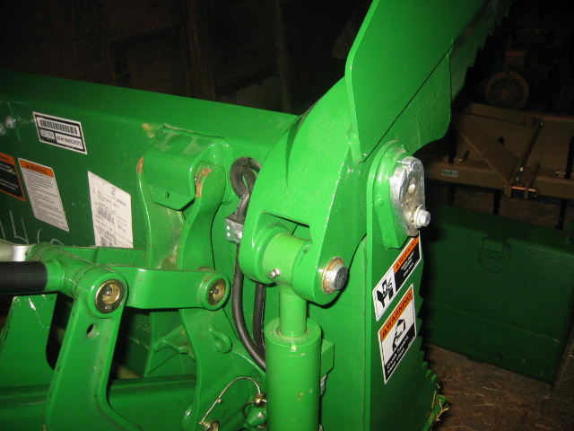

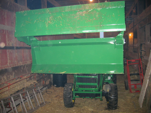

Here is a picture of mine. I was told the diffenence was in the joint and cylinder.
Dan

From Dan's pictures the one I'm looking at must be the older one as the hinges don't look as beefy and it's black not green.
From what KubotaToy and others have said it sounds like it's what I was looking for, not the perfect tool for a lot of jobs but there when you need it. I don't have a lot of brush to deal with but am getting tired of getting off of the tractor to push it into the bucket. If I have a lot of dirt work to do I'll take the hoe off and use rear implements ( I have plenty, too many if you ask my wife!) I think I'll go for it if it hasn't been sold yet.

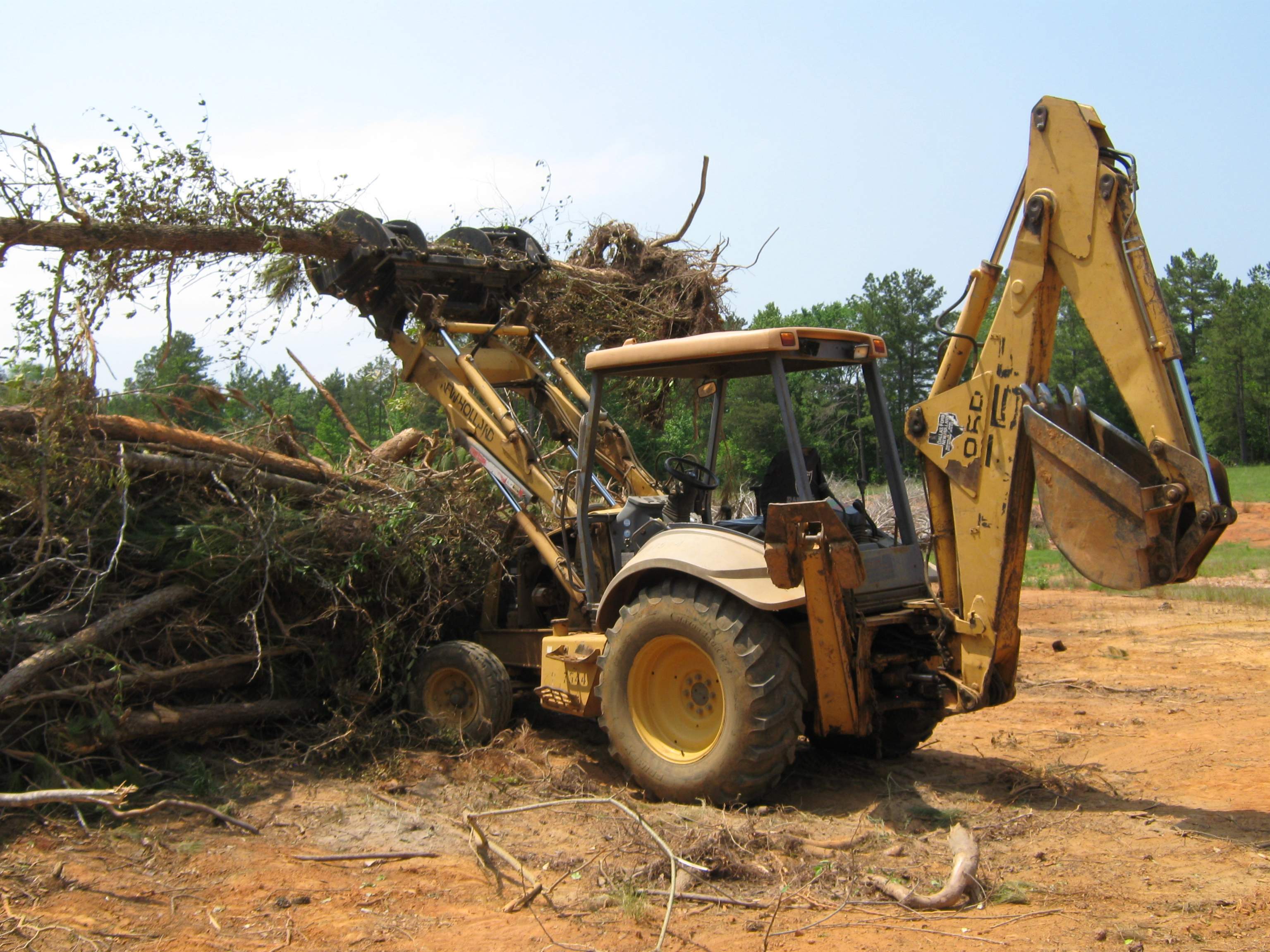

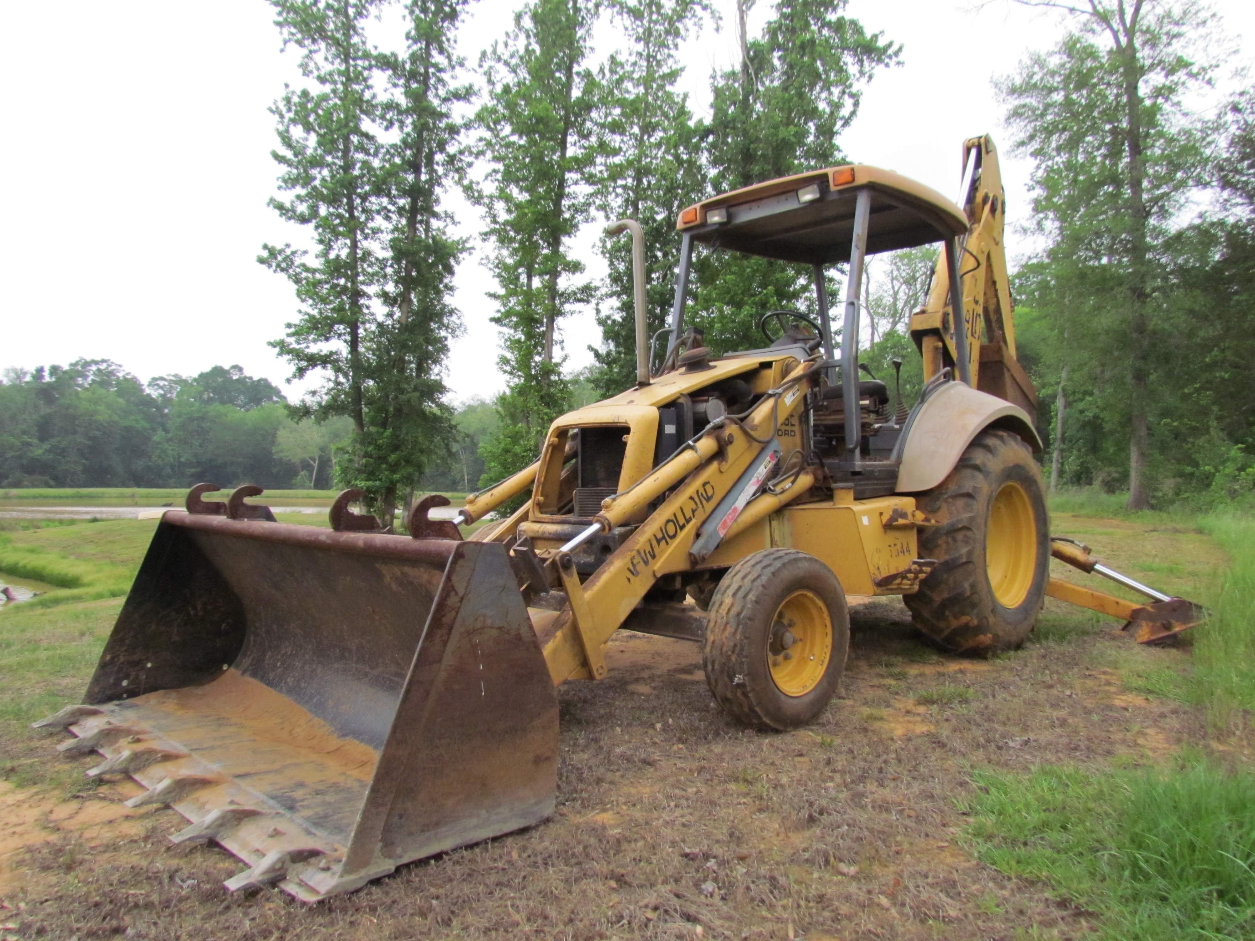

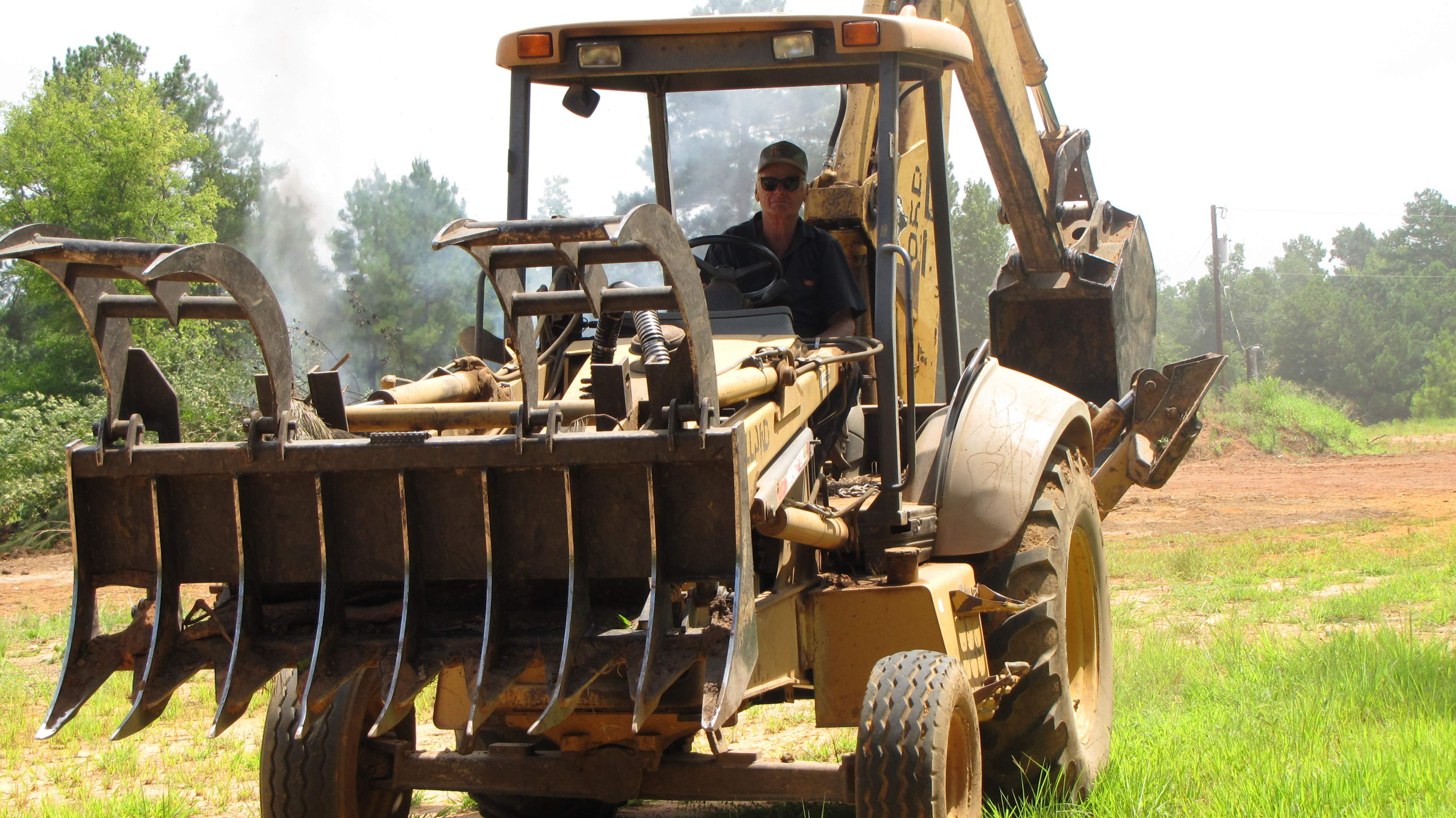

My neighbor has a full sized backhoe, LB75b with a 4 in 1 bucket on it that he likes, but he has issues with it. Since it is rigid, it does not pick up and hold very much. Just what it clamps onto. One log is fine, but a couple just fall out. He has also run into issues of moving a log and having the end of the log catch on something and twist the 4 in 1 all out of shape. He is a commercial pilot, has good coordination and knowledge of what he's doing, so it's just one of those things that happens from working all day. He and his helper will spend an antire day heating and hammering it back into shap so it will close all the way again.
I have a full sized backhoe too, 555E with a one yard bucket on it. I removed my bucket and created an adapter so I could use Quick Attach attachments that work on skid steers. I can change from one to the other in ten minutes. It's pretty simple and not something that I even think about doing. My grapple has two arms that come down independently of each other. I can pick up ten times the material that my neighbor can with his 4 in 1 bucket. If a tree is angled, I can grip it solid, where my neighbor has a tendancy to have the tree moving around when he has it. I carry my material all the way to my burn pile and rarely lose anything. He brings in a guy with a flat bed trailer and he load the trailer, then drives it to his burn pile, then unloads the trailer. With two people, I've figured that he can do half as much as I can when we're going similar distances.
The big advantage with the 4 in 1 is that it's always on, while I have to go swap bucket or grapple.
Eddie
